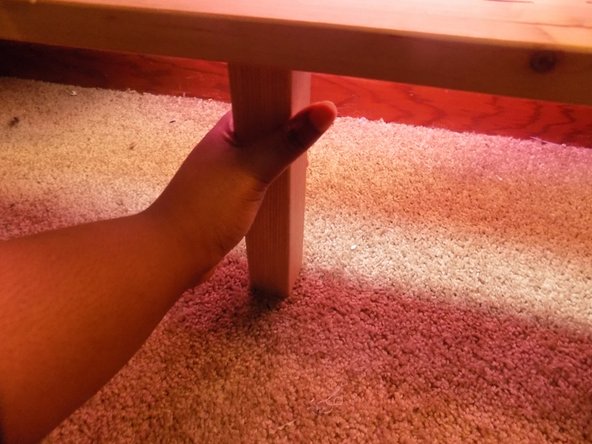

    • Place an item(s) underneath the bed rail to support it. This can be bricks or books.
  2. How to Repair a Bed Rail: crwdns2935265:02crwdnd2935265:01crwdnd2935265:01crwdne2935265:0
    • Measure the length of the slat, and mark the middle.
    • This is the position where you will place the wooden plank and hammer in the nails.
  3. How to Repair a Bed Rail: crwdns2935265:03crwdnd2935265:01crwdnd2935265:02crwdne2935265:0 How to Repair a Bed Rail: crwdns2935265:03crwdnd2935265:02crwdnd2935265:02crwdne2935265:0
    • Vertically place your pre-cut wooden plank under the slat that is detached.
  4. How to Repair a Bed Rail: crwdns2935265:04crwdnd2935265:01crwdnd2935265:01crwdne2935265:0
    • Hammer the 50 mm nails down into the slat and into the wooden plank. You can use 2 or more to ensure the wooden plank is secure.
  5. How to Repair a Bed Rail: crwdns2935265:05crwdnd2935265:01crwdnd2935265:01crwdne2935265:0
    • Afterwards, run the glue along the detached bed rail.
  6. How to Repair a Bed Rail: crwdns2935265:06crwdnd2935265:01crwdnd2935265:01crwdne2935265:0
    • Reattach the bed rail and let the glue dry.
  7. How to Repair a Bed Rail: crwdns2935265:07crwdnd2935265:01crwdnd2935265:01crwdne2935265:0
    • After the glue has dried, remove your supports.
