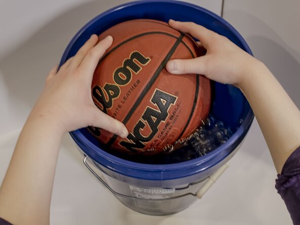

    • Locate the leak on the basketball's surface by using one of two methods: the water test or the acoustic test.
    • For the water test, fill a bucket with water, submerge the basketball in the water, and look for bubbles.

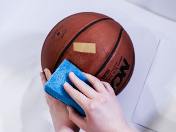

    • Once you have found the leak, mark it by placing a small strip of colored tape next to it on the surface of the ball.
  3. How to Repair a Basketball Leak: crwdns2935265:03crwdnd2935265:01crwdnd2935265:02crwdne2935265:0 How to Repair a Basketball Leak: crwdns2935265:03crwdnd2935265:02crwdnd2935265:02crwdne2935265:0
    • Clean the leak area of dirt and debris with a clean sponge, soap, and water.

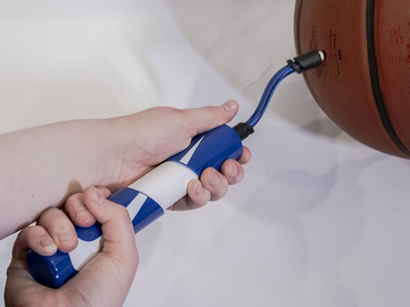

    • Deflate the ball by 20% of the air it currently contains by placing the inflation needle from the ball pump into the inflation hole of the ball until air is released.
    • This will make it easier to place the patch on the ball as it will prevent an excessive amount of air from drying the glue too quickly on the leak area.

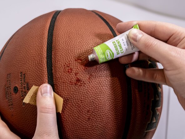

    • Use your Slime Tube Patch Kit in the following 4 steps:
    • Take the metal scuffer and sand the leak area.
    • One side of the metal scuffer is very sharp. Be careful to hold the ball so that your fingers are away from the leak area or you could be cut.
    • Apply a thin layer of rubber cement to cover 1 centimeter wider in diameter than the leak area.

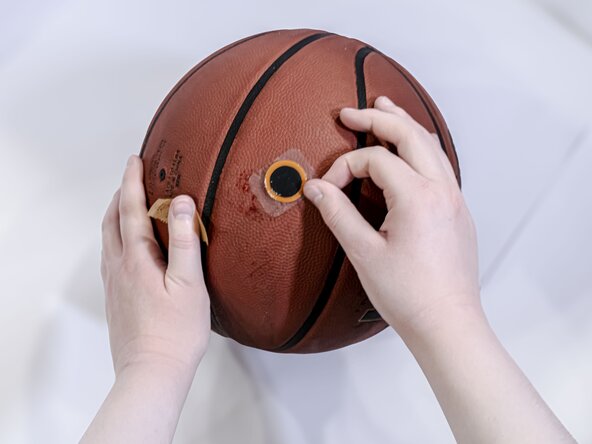

    • Place the appropriate sized patch over the whole leak area and gently press it onto the ball's surface.
    • Wait 1 hour for the adhesive to fully dry.
  6. How to Repair a Basketball Leak: crwdns2935265:06crwdnd2935265:01crwdnd2935265:02crwdne2935265:0 How to Repair a Basketball Leak: crwdns2935265:06crwdnd2935265:02crwdnd2935265:02crwdne2935265:0
    • Reinflate the basketball.
Test your ball to see if the leak has been repaired. If the ball still loses air in a short amount of time, there may be more leaks. Repeat this process to locate and fix them.
