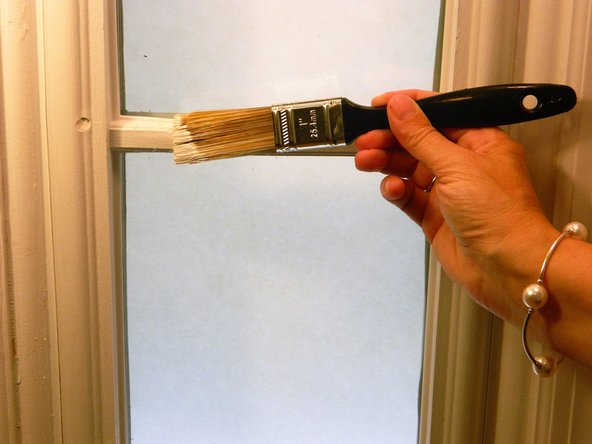

  7. How to Repair Wood Dents with Wood Filler: crwdns2935265:07crwdnd2935265:01crwdnd2935265:01crwdne2935265:0
    • Optional: Paint the surface with white paint from a can of Rust-Oleum if the stain is not the desired color for the surface.
    • Use a 25 mm paint brush and an 8 ounce can of Rust-Oleum.
    • Multiple coats map be applied to reach the desired color.
  8. How to Repair Wood Dents with Wood Filler: crwdns2935265:08crwdnd2935265:01crwdnd2935265:01crwdne2935265:0
    • Dry the surface by patting the surface with a cloth towel.
