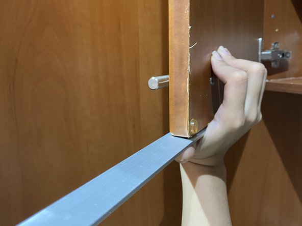

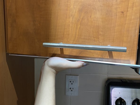

  3. How to Repair Warped Cabinet Veneer: crwdns2935265:03crwdnd2935265:01crwdnd2935265:03crwdne2935265:0 How to Repair Warped Cabinet Veneer: crwdns2935265:03crwdnd2935265:02crwdnd2935265:03crwdne2935265:0 How to Repair Warped Cabinet Veneer: crwdns2935265:03crwdnd2935265:03crwdnd2935265:03crwdne2935265:0
    • Place your brace over the damaged area and keep pressure on it.

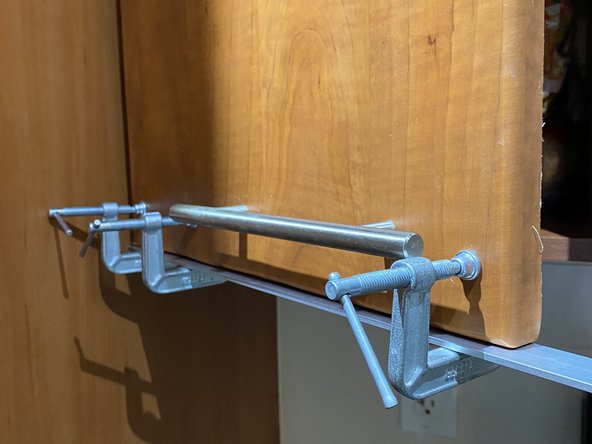

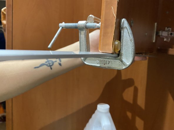

  4. How to Repair Warped Cabinet Veneer: crwdns2935265:04crwdnd2935265:01crwdnd2935265:03crwdne2935265:0 How to Repair Warped Cabinet Veneer: crwdns2935265:04crwdnd2935265:02crwdnd2935265:03crwdne2935265:0 How to Repair Warped Cabinet Veneer: crwdns2935265:04crwdnd2935265:03crwdnd2935265:03crwdne2935265:0
    • Maintaining pressure on the brace, apply the first clamp around the pieces.
    • Make sure the clamp is holding the brace flush, then tighten it into place.
    • Add as many clamps as necessary to keep the brace flush.

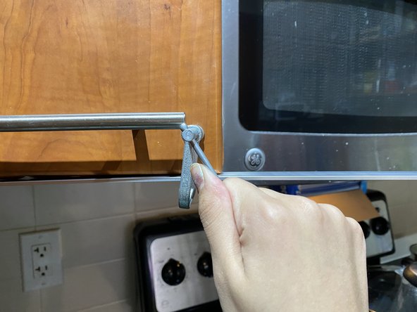

  5. How to Repair Warped Cabinet Veneer: crwdns2935265:05crwdnd2935265:01crwdnd2935265:02crwdne2935265:0 How to Repair Warped Cabinet Veneer: crwdns2935265:05crwdnd2935265:02crwdnd2935265:02crwdne2935265:0
    • Once all clamps are secured, refer to the rubber cement label to determine the approximate drying time.
    • While most rubber cement will dry within 2-3 minutes, it's a safe bet to leave the clamps secured overnight.
