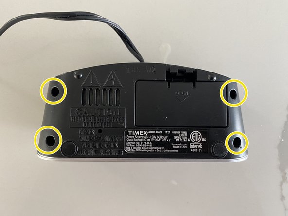

    • Unplug the alarm clock from the power.
    • Flip the alarm clock upside down and open the lid.
    • Take out the batteries and leave them aside.
  2. How to Repair Timex t121b Buttons: crwdns2935265:02crwdnd2935265:01crwdnd2935265:03crwdne2935265:0 How to Repair Timex t121b Buttons: crwdns2935265:02crwdnd2935265:02crwdnd2935265:03crwdne2935265:0 How to Repair Timex t121b Buttons: crwdns2935265:02crwdnd2935265:03crwdnd2935265:03crwdne2935265:0
    • Use a Phillips screwdriver to remove all of the screws on the underside of the clock.
    • Carefully lift the cover and lay it down as shown in the third image.

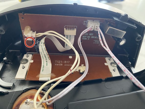

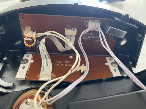

  3. How to Repair Timex t121b Buttons: crwdns2935265:03crwdnd2935265:01crwdnd2935265:03crwdne2935265:0 How to Repair Timex t121b Buttons: crwdns2935265:03crwdnd2935265:02crwdnd2935265:03crwdne2935265:0 How to Repair Timex t121b Buttons: crwdns2935265:03crwdnd2935265:03crwdnd2935265:03crwdne2935265:0
    • Flip the alarm clock until the top of the clock is facing down.
    • Take out the first screw (1.2 mm Phillips) as shown in the second image.
    • Take out the second screw (1.2 mm Phillips) as shown in the third image.

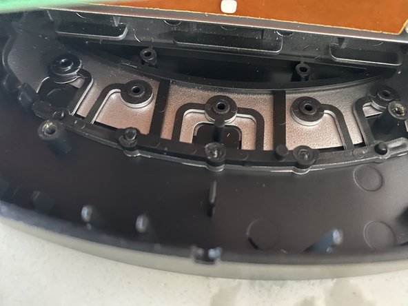

  4. How to Repair Timex t121b Buttons: crwdns2935265:04crwdnd2935265:01crwdnd2935265:03crwdne2935265:0 How to Repair Timex t121b Buttons: crwdns2935265:04crwdnd2935265:02crwdnd2935265:03crwdne2935265:0 How to Repair Timex t121b Buttons: crwdns2935265:04crwdnd2935265:03crwdnd2935265:03crwdne2935265:0
    • Carefully check the buttons and make sure you are able to press all the buttons.
    • Clean any dust that might be interfering with the buttons.

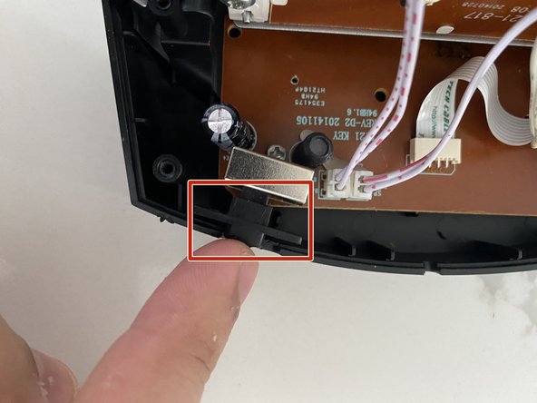

    • Adjust and push the alarm slide button to its proper position as shown in the third image.
