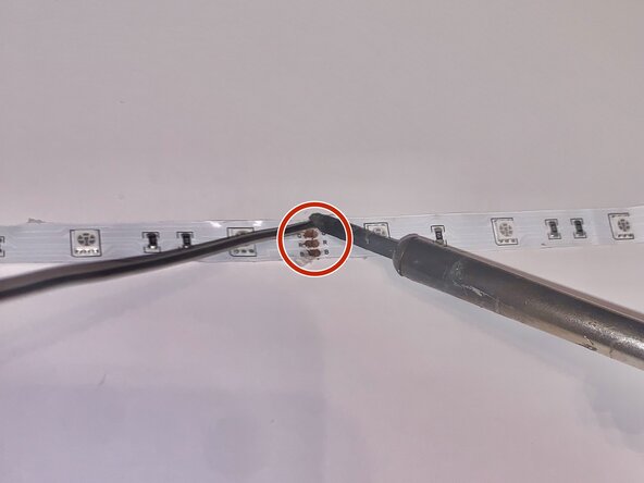

Find the spot where the lights stop working and where there are four connections labeled in descending order, "12V, R, G, B" with a scissor "cut here" marking and a copper colored backing.
With a scissor, cut along the "cut here" line, separating the faulty strip from the working strip.
crwdns2935267:0crwdne2935267:0FixHub | Power Series Smart Soldering Iron$79.95
Align the new strip next to the working strip and keep them steady. Look at the four connections like a mirror image. R to R, G to G, etc.
Use a soldering iron to solder all four connections.
Once the four connections are soldered securely, plug in the strip and turn the lights to all three colors to ensure that the connections are steady. Now you may place the lights where so desired.
