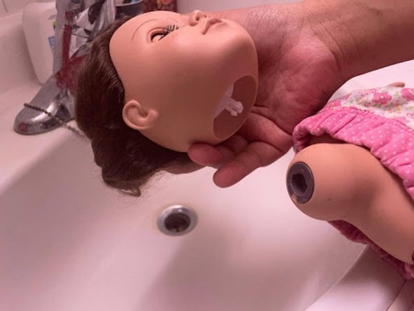

    • Remove the doll's head by loosening the neck strings.
    • To loosen the neck strings, turn the doll's head from left to right occasionally pulling the head until you are able to fully pull its head away from the body of the doll.
    • Make sure to remove any fiber fill inside the doll, if it contains the material.
