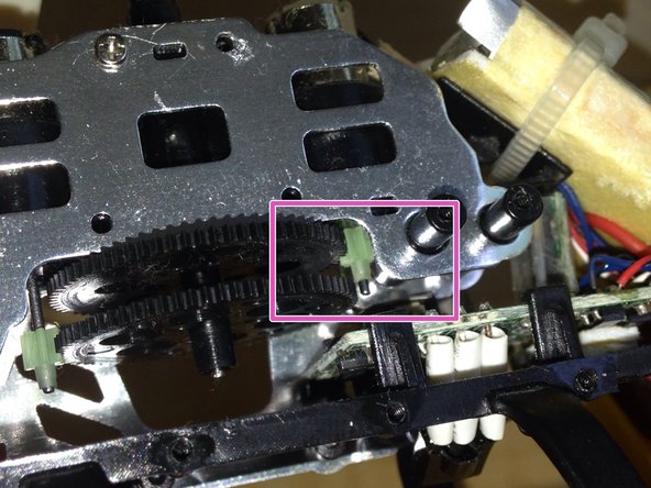

    • Locate the problematic engine gear inside the helicopter frame.
    • It will seem out of place and will not connect with the rotor gear.
    • The white gear can be clearly seen out of place and not in contact with the upper rotor gear. This does not allow the blades to spin.

  4. How to Repair Displaced Engine Gears in a Remote Controlled Helicopter: crwdns2935265:04crwdnd2935265:01crwdnd2935265:01crwdne2935265:0
    • If it is possible to reset the gear without unscrewing further, attempt to push the gear back up into place on the motor shaft with a screwdriver or your finger.
    • If this works you have fixed the gear and can skip to step 7.
    • If the gear is inaccessible you will have to open the frame, go to step 5.
  5. How to Repair Displaced Engine Gears in a Remote Controlled Helicopter: crwdns2935265:05crwdnd2935265:01crwdnd2935265:02crwdne2935265:0 How to Repair Displaced Engine Gears in a Remote Controlled Helicopter: crwdns2935265:05crwdnd2935265:02crwdnd2935265:02crwdne2935265:0
    • Unscrew one side of the frame and set it aside, allowing access to the gear.
    • Make sure all the screws and frame pieces are kept in a secure location.
  6. How to Repair Displaced Engine Gears in a Remote Controlled Helicopter: crwdns2935265:06crwdnd2935265:01crwdnd2935265:02crwdne2935265:0 How to Repair Displaced Engine Gears in a Remote Controlled Helicopter: crwdns2935265:06crwdnd2935265:02crwdnd2935265:02crwdne2935265:0
    • Place the screwdriver's tip underneath the clear motor gear.
    • Firmly push the gear back up into place so that it correctly connects with the main rotor gear.
    • See the last picture for a proper gear connecion visual.

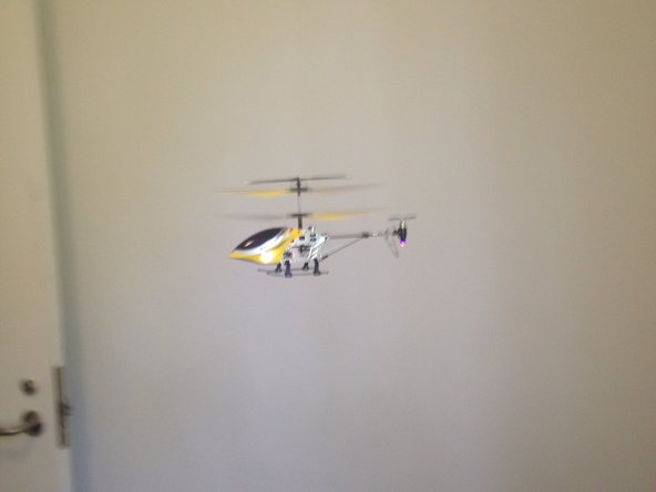

    • Test the helicopter for functionality.
    • If it works then the helicopter is fixed and you can screw the shroud back into place.
To reassemble, after testing for functionality, make sure all inner parts are back in their original location. Screw the frame and shroud tightly back in place.
