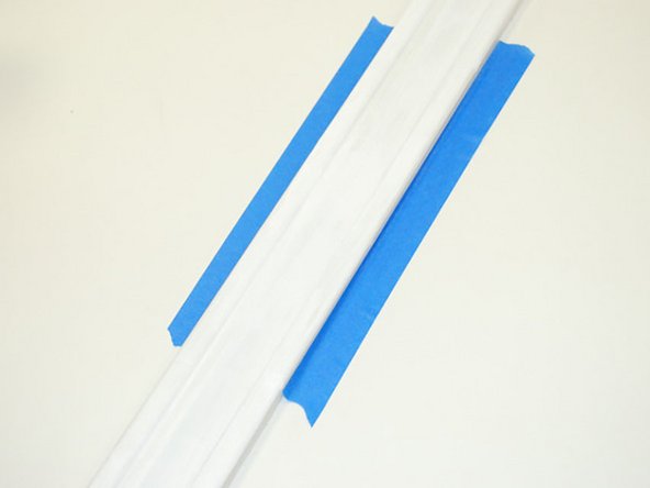

    • Tape the edges around the damaged area of the trim with masking tape.
  7. How to Repair Damaged Door or Window Casing: crwdns2935265:07crwdnd2935265:01crwdnd2935265:02crwdne2935265:0 How to Repair Damaged Door or Window Casing: crwdns2935265:07crwdnd2935265:02crwdnd2935265:02crwdne2935265:0

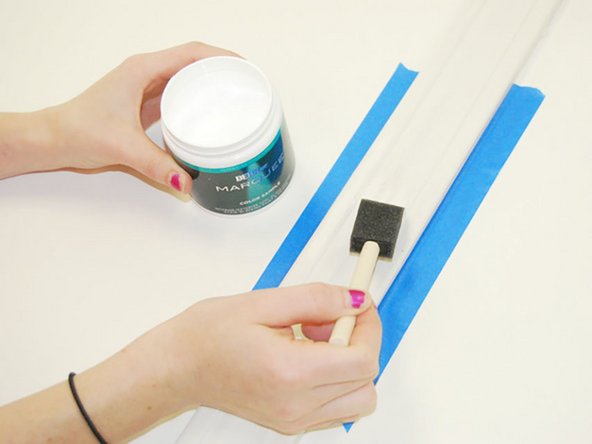

    • Paint the trim to match the original color.
    • Allow the paint to dry before removing the tape.
