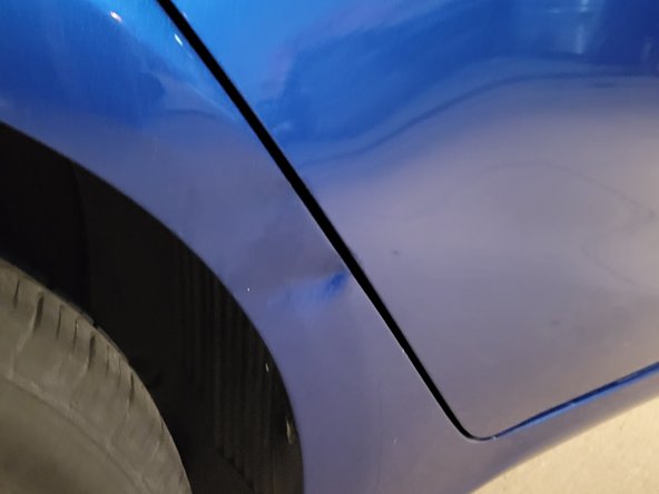

How to Repair Automobile Scratches & Paint Chips
  1. How to Repair Automobile Scratches & Paint Chips, How to Repair Automobile Scratches & Paint Chips: crwdns2935265:01crwdnd2935265:01crwdnd2935265:01crwdne2935265:0

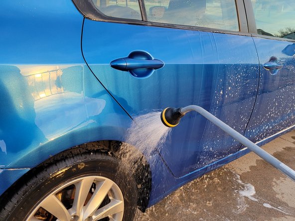

  3. How to Repair Automobile Scratches & Paint Chips: crwdns2935265:03crwdnd2935265:01crwdnd2935265:03crwdne2935265:0 How to Repair Automobile Scratches & Paint Chips: crwdns2935265:03crwdnd2935265:02crwdnd2935265:03crwdne2935265:0 How to Repair Automobile Scratches & Paint Chips: crwdns2935265:03crwdnd2935265:03crwdnd2935265:03crwdne2935265:0
    • Use soapy water and sponge to wash the car.
    • Rinse off the soap with a water hose.

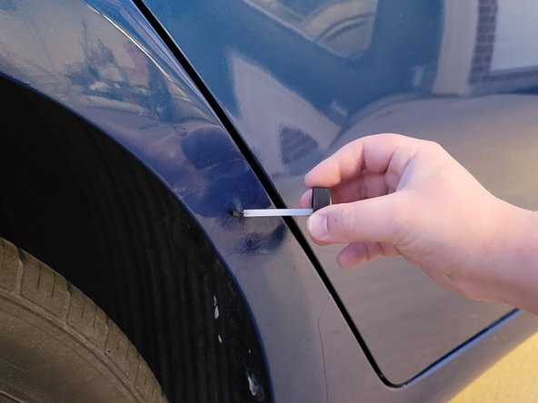

    • Starting with a small amount of paint, apply the first coat of paint to the scratched area.
    • Use as little paint as possible to prevent clumping.
    • Wait 15-20 minutes for the coat to fully dry before continuing.
  8. How to Repair Automobile Scratches & Paint Chips: crwdns2935265:08crwdnd2935265:01crwdnd2935265:02crwdne2935265:0 How to Repair Automobile Scratches & Paint Chips: crwdns2935265:08crwdnd2935265:02crwdnd2935265:02crwdne2935265:0
    • If necessary, apply a second coat of paint to the area.
    • This may be necessary for deep scratches or chips.
    • Wait 15-20 minutes before continuing.
    • Continue to reapply if needed.

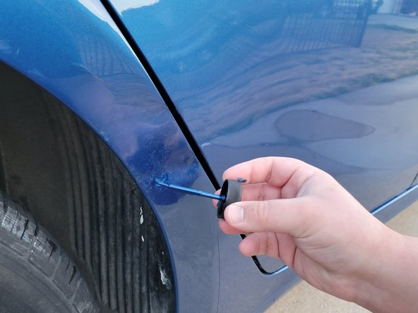

  9. How to Repair Automobile Scratches & Paint Chips: crwdns2935265:09crwdnd2935265:01crwdnd2935265:03crwdne2935265:0 How to Repair Automobile Scratches & Paint Chips: crwdns2935265:09crwdnd2935265:02crwdnd2935265:03crwdne2935265:0 How to Repair Automobile Scratches & Paint Chips: crwdns2935265:09crwdnd2935265:03crwdnd2935265:03crwdne2935265:0
    • Use the small paintbrush to apply clear coat over the freshly dried paint.
    • Wait 10-15 minutes for the clear coat to dry.
