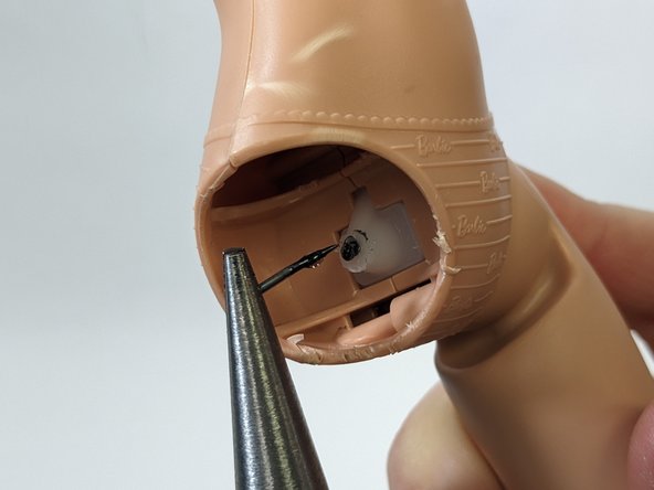

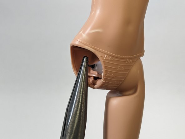

    • Determine where your doll is broken: is it at the knee? Hip? Arm?
    • If it’s broken at the knee, as marked in the second photo, unfortunately this guide will not help as it is a different kind of joint.
  2. How to Repair A Broken Hip In A Plastic Doll: crwdns2935265:02crwdnd2935265:01crwdnd2935265:02crwdne2935265:0 How to Repair A Broken Hip In A Plastic Doll: crwdns2935265:02crwdnd2935265:02crwdnd2935265:02crwdne2935265:0
    • If the ball is still inside the leg, remove it with pliers.

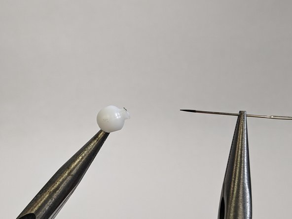

  3. How to Repair A Broken Hip In A Plastic Doll: crwdns2935265:03crwdnd2935265:01crwdnd2935265:01crwdne2935265:0
    • Hold one of the sewing pins with the pliers and heat the sewing pin with a lighter.
    • Do not leave fire unattended. The metal will be hot, so please don't touch it with your bare skin.
  4. How to Repair A Broken Hip In A Plastic Doll: crwdns2935265:04crwdnd2935265:01crwdnd2935265:01crwdne2935265:0
    • With the hot sewing needle, make a small hole in the center of the broken off ball. Make sure the needle is straight.
    • This may take a few attempts and a few needles.
    • Heating up the plastic will result in some fumes. Perform this step in a well ventilated area.

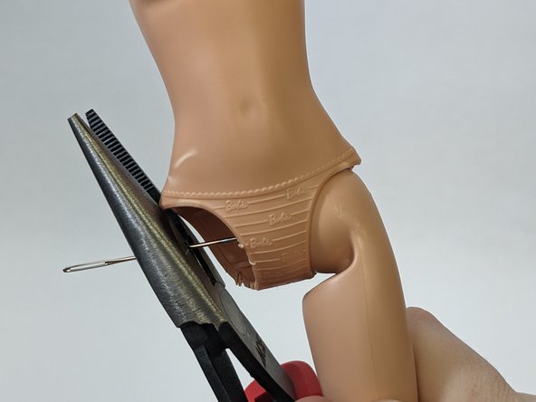

  6. How to Repair A Broken Hip In A Plastic Doll: crwdns2935265:06crwdnd2935265:01crwdnd2935265:02crwdne2935265:0 How to Repair A Broken Hip In A Plastic Doll: crwdns2935265:06crwdnd2935265:02crwdnd2935265:02crwdne2935265:0
    • With the hot sewing needle, make a small hole in the peg of the hip. Make sure the needle is straight. Leave the pin inside.
  7. How to Repair A Broken Hip In A Plastic Doll: crwdns2935265:07crwdnd2935265:01crwdnd2935265:02crwdne2935265:0 How to Repair A Broken Hip In A Plastic Doll: crwdns2935265:07crwdnd2935265:02crwdnd2935265:02crwdne2935265:0
    • Remove the pin from the broken off ball joint with a pair of pliers.
  8. How to Repair A Broken Hip In A Plastic Doll: crwdns2935265:08crwdnd2935265:01crwdnd2935265:02crwdne2935265:0 How to Repair A Broken Hip In A Plastic Doll: crwdns2935265:08crwdnd2935265:02crwdnd2935265:02crwdne2935265:0
    • Using the pliers, cut the pin in the hip section to the appropriate length to fit into the hole made from Step 6.
    • Test the needle length by fitting the ball joint pieces together. The needle should be completely covered.
    • The needle will go flying when you cut it, so direct it away from your face and other precious objects.
