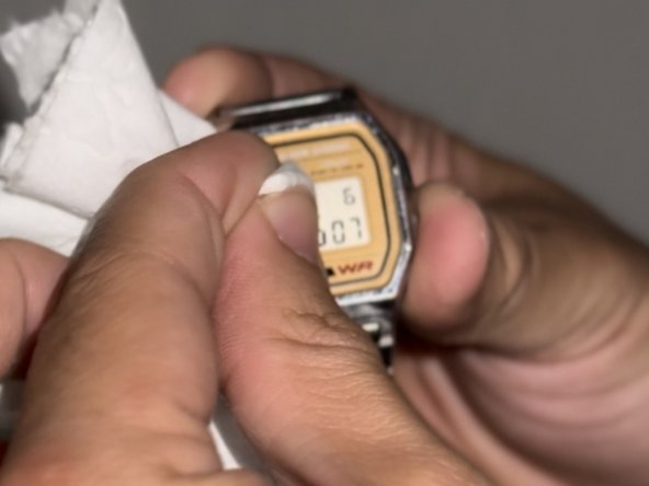

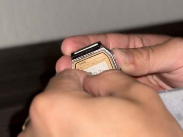

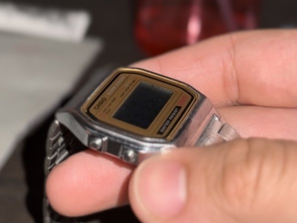

    • Examine the damage and identify the boundaries for buffing the face of the watch.
    • Working with sandpaper can damage other areas of the watch, so understanding your working area will prevent any careless mistakes.
  2. How to Remove the Scratches from an Acrylic Watch Face: crwdns2935265:02crwdnd2935265:01crwdnd2935265:03crwdne2935265:0 How to Remove the Scratches from an Acrylic Watch Face: crwdns2935265:02crwdnd2935265:02crwdnd2935265:03crwdne2935265:0 How to Remove the Scratches from an Acrylic Watch Face: crwdns2935265:02crwdnd2935265:03crwdnd2935265:03crwdne2935265:0

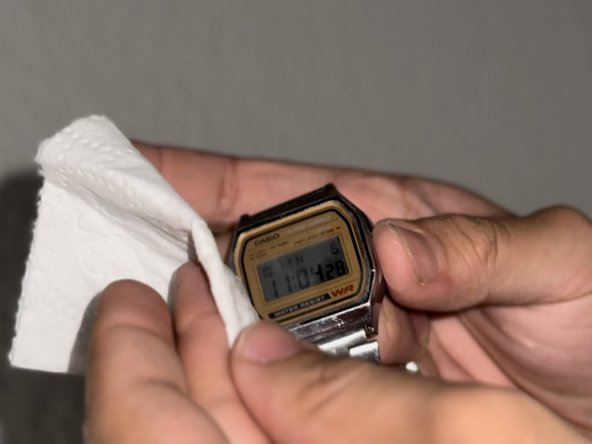

    • Wipe the watch surface with a paper towel dampened with isopropyl alcohol.
    • It is important to clean the watch of any surface debris to prevent making new scratches.

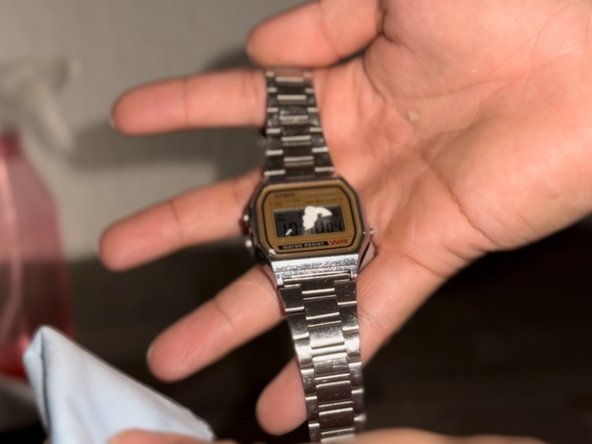

  3. How to Remove the Scratches from an Acrylic Watch Face: crwdns2935265:03crwdnd2935265:01crwdnd2935265:03crwdne2935265:0 How to Remove the Scratches from an Acrylic Watch Face: crwdns2935265:03crwdnd2935265:02crwdnd2935265:03crwdne2935265:0 How to Remove the Scratches from an Acrylic Watch Face: crwdns2935265:03crwdnd2935265:03crwdnd2935265:03crwdne2935265:0

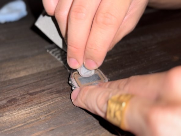

    • Use the 1000-grit sandpaper, and gently sand the face of the watch in a circular motion.
    • This step is to remove any deep scratches.

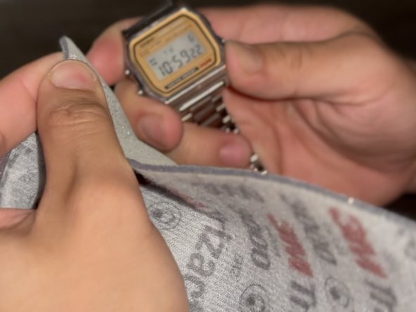

  4. How to Remove the Scratches from an Acrylic Watch Face: crwdns2935265:04crwdnd2935265:01crwdnd2935265:03crwdne2935265:0 How to Remove the Scratches from an Acrylic Watch Face: crwdns2935265:04crwdnd2935265:02crwdnd2935265:03crwdne2935265:0 How to Remove the Scratches from an Acrylic Watch Face: crwdns2935265:04crwdnd2935265:03crwdnd2935265:03crwdne2935265:0
    • With your fingernail, feel the surface of the watch for any remaining deep scratches.
    • Keep sanding until you no longer feel scratches.

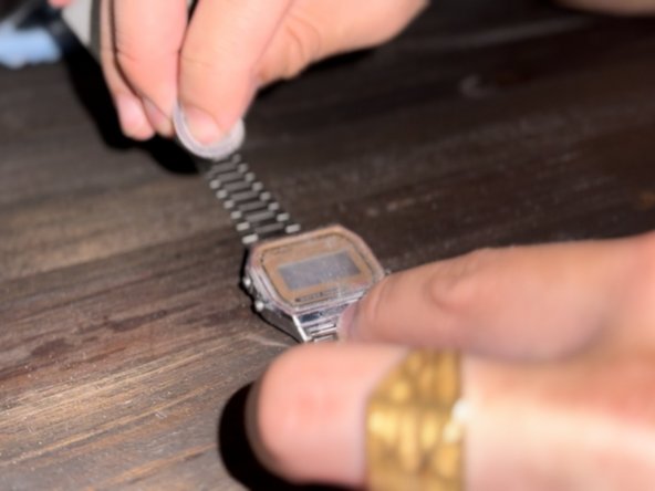

  5. How to Remove the Scratches from an Acrylic Watch Face: crwdns2935265:05crwdnd2935265:01crwdnd2935265:02crwdne2935265:0 How to Remove the Scratches from an Acrylic Watch Face: crwdns2935265:05crwdnd2935265:02crwdnd2935265:02crwdne2935265:0
    • Clean the surface again with a paper towel and isopropyl alcohol to prep the watch face for polishing.

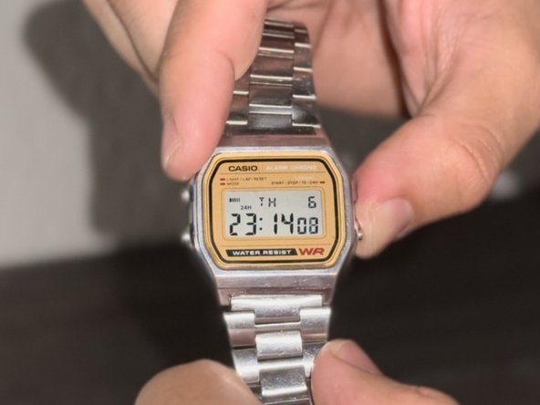

    • With the microfiber cloth, begin working on the face of the watch in a circular motion for at least 2-3 minutes.
    • Wipe away any excess compound with a clean cloth and examine your results.
  8. How to Remove the Scratches from an Acrylic Watch Face: crwdns2935265:08crwdnd2935265:01crwdnd2935265:02crwdne2935265:0 How to Remove the Scratches from an Acrylic Watch Face: crwdns2935265:08crwdnd2935265:02crwdnd2935265:02crwdne2935265:0
    • Repeat the process until you are satisfied with the results.
Now, your watch should look close to the day you bought it!
