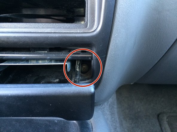

    • A Chevy Tracker will have a trim that surrounds the stereo.
    • The trim is the black plastic that encompasses the stereo and the small tray/compartment.
    • Remove the screw located on the underside of the trim above the car stereo.
  4. How to Remove a Car Stereo in a Chevy Tracker: crwdns2935265:04crwdnd2935265:01crwdnd2935265:03crwdne2935265:0 How to Remove a Car Stereo in a Chevy Tracker: crwdns2935265:04crwdnd2935265:02crwdnd2935265:03crwdne2935265:0 How to Remove a Car Stereo in a Chevy Tracker: crwdns2935265:04crwdnd2935265:03crwdnd2935265:03crwdne2935265:0
    • Unscrew the two screws hidden behind the tiny tray/compartment.
    • Afterwards, you can safely remove the trim.

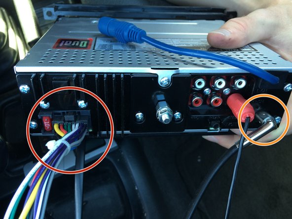

    • Carefully remove the stereo.
    • Look behind the stereo to see how it is connected.
    • The grouped up, different colored collection of wires connect to the speakers, amplifiers, and stereo buttons depending on the color.
    • The thick, metal wire connects to the car antennae.
    • Don't pull too hard! There are connections to the radio that we need to unplug.
  7. How to Remove a Car Stereo in a Chevy Tracker: crwdns2935265:07crwdnd2935265:01crwdnd2935265:03crwdne2935265:0 How to Remove a Car Stereo in a Chevy Tracker: crwdns2935265:07crwdnd2935265:02crwdnd2935265:03crwdne2935265:0 How to Remove a Car Stereo in a Chevy Tracker: crwdns2935265:07crwdnd2935265:03crwdnd2935265:03crwdne2935265:0

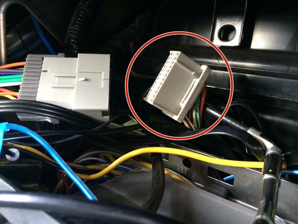

    • Unplugging the connections, except for the multicolored group of wires. All are located on the back of stereo should be as simple as pulling on them.
    • "To remove the group of wires", follow the wires until you reach a connector and unplug the connector.

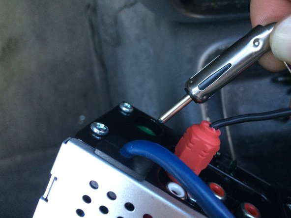

    • The thick, metal wire connecting to the radio antennae can be easily removed by pulling on it.
    • The harness (the grayish female connector circled in red) is what connects the wires to the various components of the car.
