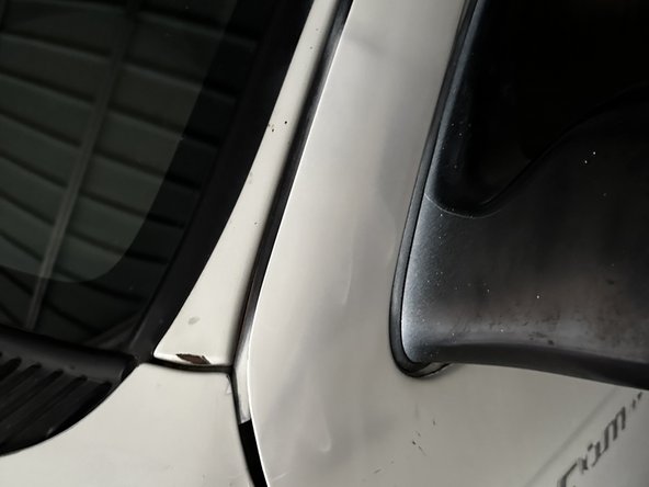

    • Spray down the rust with a spray bottle mixed with water and dish soap.
    • Wipe the mixture with a microfiber cloth.

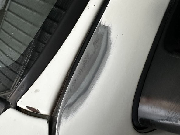

  2. How to Remove Rust on Car Body: crwdns2935265:02crwdnd2935265:01crwdnd2935265:03crwdne2935265:0 How to Remove Rust on Car Body: crwdns2935265:02crwdnd2935265:02crwdnd2935265:03crwdne2935265:0 How to Remove Rust on Car Body: crwdns2935265:02crwdnd2935265:03crwdnd2935265:03crwdne2935265:0
    • Pour a small amount of rubbing alcohol onto a microfiber cloth.
    • Clean the rusted area with the cloth to remove any contaminants.

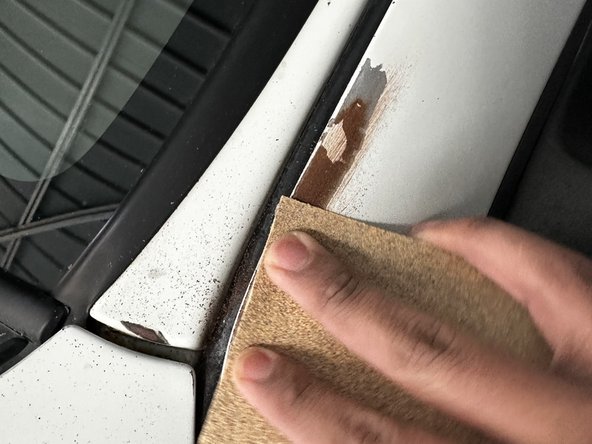

  3. How to Remove Rust on Car Body: crwdns2935265:03crwdnd2935265:01crwdnd2935265:03crwdne2935265:0 How to Remove Rust on Car Body: crwdns2935265:03crwdnd2935265:02crwdnd2935265:03crwdne2935265:0 How to Remove Rust on Car Body: crwdns2935265:03crwdnd2935265:03crwdnd2935265:03crwdne2935265:0
    • Rub the rusted area with 80-grit sandpaper until you start seeing the bare metal.
  4. How to Remove Rust on Car Body: crwdns2935265:04crwdnd2935265:01crwdnd2935265:02crwdne2935265:0 How to Remove Rust on Car Body: crwdns2935265:04crwdnd2935265:02crwdnd2935265:02crwdne2935265:0
    • Rub the rusted area with 220-grit sandpaper until all of the rust is removed.
    • Dampen a cloth with soapy water and wipe down the sanded area.

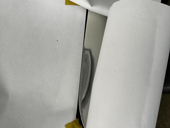

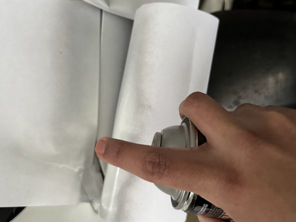

  5. How to Remove Rust on Car Body: crwdns2935265:05crwdnd2935265:01crwdnd2935265:02crwdne2935265:0 How to Remove Rust on Car Body: crwdns2935265:05crwdnd2935265:02crwdnd2935265:02crwdne2935265:0
    • This step is to prepare your spot for spray painting.
    • Add some paper around the areas you do not want paint on. Make sure you go a little past where you are going to spray paint to blend the paint into the surrounding area.

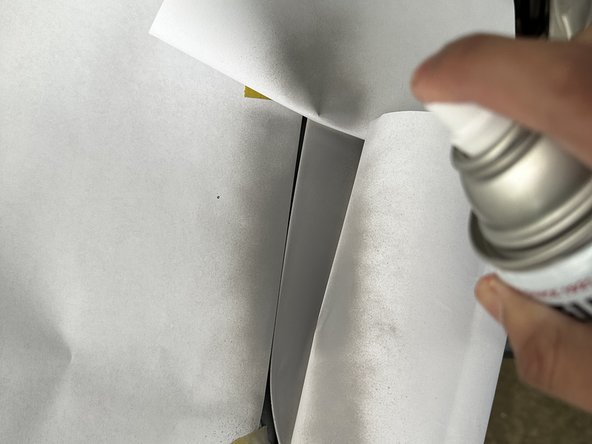

  6. How to Remove Rust on Car Body: crwdns2935265:06crwdnd2935265:01crwdnd2935265:03crwdne2935265:0 How to Remove Rust on Car Body: crwdns2935265:06crwdnd2935265:02crwdnd2935265:03crwdne2935265:0 How to Remove Rust on Car Body: crwdns2935265:06crwdnd2935265:03crwdnd2935265:03crwdne2935265:0
    • Spray three even coats of primer, waiting at least five minutes between each coat.
    • Let the third coat sit for 15 minutes.

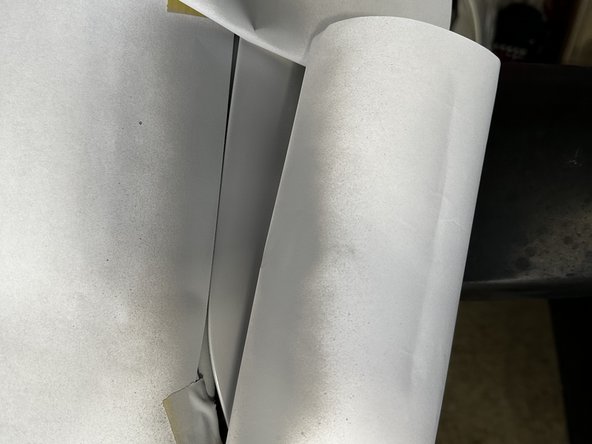

  7. How to Remove Rust on Car Body: crwdns2935265:07crwdnd2935265:01crwdnd2935265:03crwdne2935265:0 How to Remove Rust on Car Body: crwdns2935265:07crwdnd2935265:02crwdnd2935265:03crwdne2935265:0 How to Remove Rust on Car Body: crwdns2935265:07crwdnd2935265:03crwdnd2935265:03crwdne2935265:0
    • Spray three even coats of paint on top of the primer, waiting five minutes between each coat.
    • You can either use a color similar to your car or you can get the actual color of you car by looking for the car's color code.
    • After the final coat, wait 24 hours before removing the surrounding paper.
