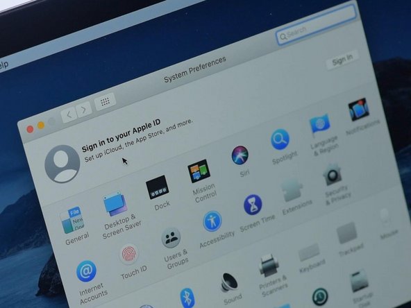

    • First of all, let’s turn on the MacBook. Activation lock is showing.

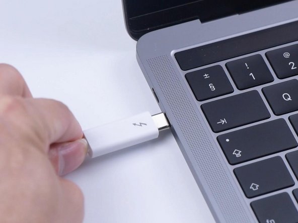

    • After the data have been written, the MacBook is in DFU mode. The MacBook is unable to turn on. Connect the MacBook to another MacBook with a data cable. Please plug the cable into the left bottom Type-C.

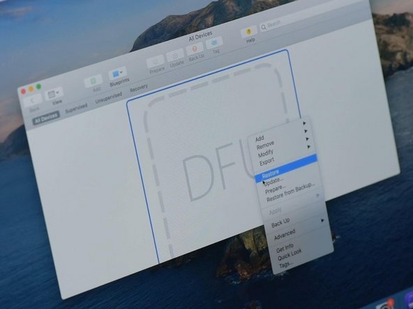

    • Open Apple Configurator 2. Right click to select “Restore”. Begin restoring.

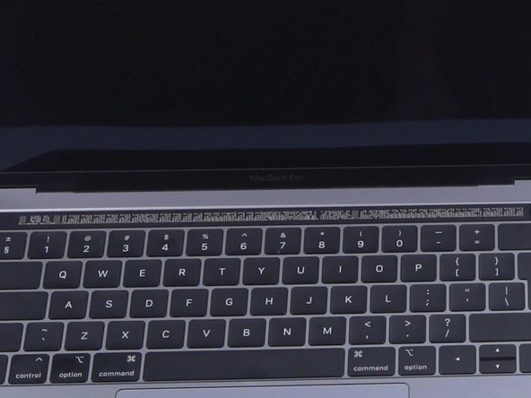

    • Plug in the T203 USB to read the MacBook data. The MacBook data is successfully read if the Touch Bar has shown some images.
