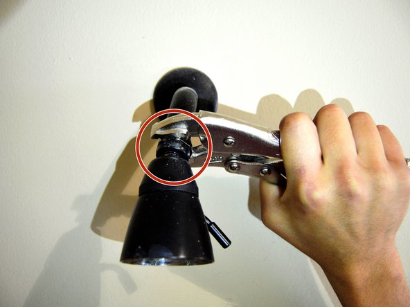

    • Using an adjustable wrench, loosen the bolt that attaches the shower head to the wall spout by turning the wrench counterclockwise.
    • You may be able to loosen the shower head by hand.
    • Handle carefully because the shower head may be heavy.
  2. How to Remove Calcium Buildup from a Shower Head: crwdns2935265:02crwdnd2935265:01crwdnd2935265:01crwdne2935265:0
    • Use your hands to finish unscrewing the bolt.
    • Remove the shower head from the wall spout.

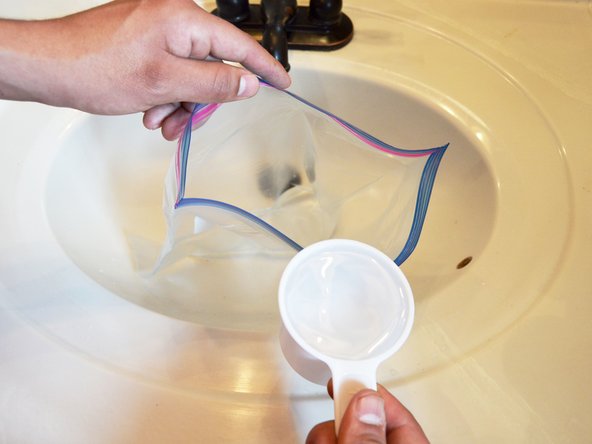

    • Pour one cup of water into the plastic bag.
    • Completing this step over a sink may help to avoid spilling the water.

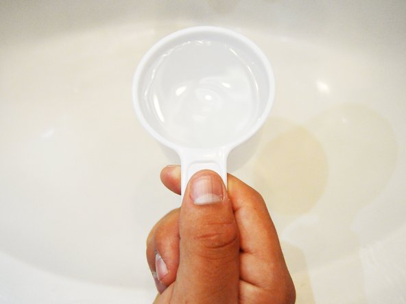

    • Pour one cup of distilled vinegar into the plastic bag.
    • Completing this step over a sink may help to avoid spilling the solution.
    • If using the vinegar solution provided in steps 3 and 4 fails to provide adequate results, you may want to repeat the steps using CLR (Calcium, Lime, and Rust) solution instead.

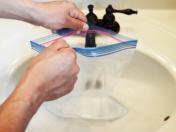

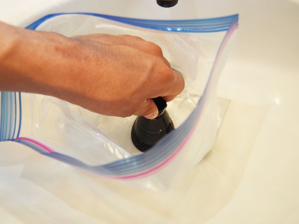

    • Place the shower head face down into the plastic bag of vinegar solution.
    • Let the shower head sit for one hour before removing it from the plastic bag of vinegar solution.

    • Clamp the adjustable wrench onto the bolt of the shower head.
    • Turn the adjustable wrench clockwise to tighten the shower head back onto the water spout.
