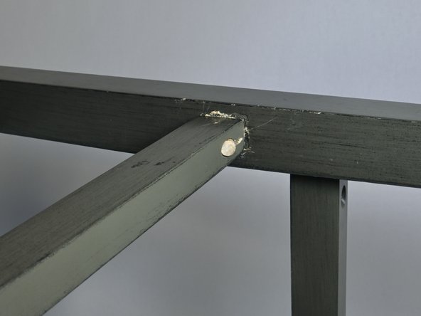

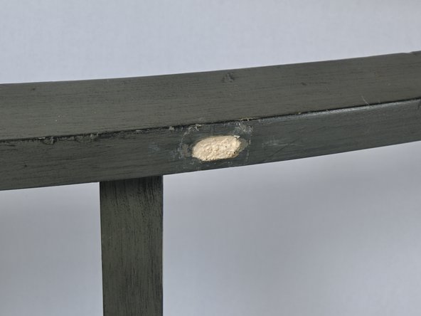

    • Use the sandpaper to rough up the empty dowel holes on the side stretcher and the chairs legs.
  2. How to Reinsert a Wooden Chair Side Stretcher: crwdns2935265:02crwdnd2935265:01crwdnd2935265:02crwdne2935265:0 How to Reinsert a Wooden Chair Side Stretcher: crwdns2935265:02crwdnd2935265:02crwdnd2935265:02crwdne2935265:0
    • Check if the new dowel fits through the stretcher hole and the leg hole.

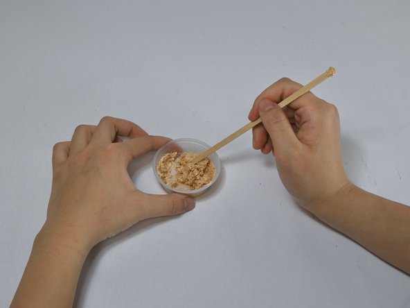

  3. How to Reinsert a Wooden Chair Side Stretcher: crwdns2935265:03crwdnd2935265:01crwdnd2935265:03crwdne2935265:0 How to Reinsert a Wooden Chair Side Stretcher: crwdns2935265:03crwdnd2935265:02crwdnd2935265:03crwdne2935265:0 How to Reinsert a Wooden Chair Side Stretcher: crwdns2935265:03crwdnd2935265:03crwdnd2935265:03crwdne2935265:0

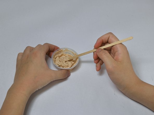

    • Using the disposable stirrer and bowl, mix a 2:1 ratio of sawdust and wood glue.
    • The final consistency should be paste-like.
  4. How to Reinsert a Wooden Chair Side Stretcher: crwdns2935265:04crwdnd2935265:01crwdnd2935265:03crwdne2935265:0 How to Reinsert a Wooden Chair Side Stretcher: crwdns2935265:04crwdnd2935265:02crwdnd2935265:03crwdne2935265:0 How to Reinsert a Wooden Chair Side Stretcher: crwdns2935265:04crwdnd2935265:03crwdnd2935265:03crwdne2935265:0

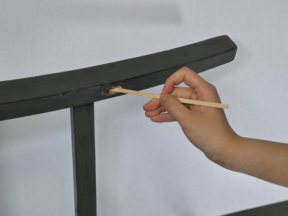

    • With the stirrer, fill in the leg hole of the broken dowel with the paste.

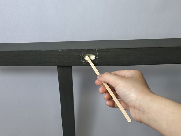

    • Apply a glob of wood glue to the other leg's hole.
    • Use the stirrer to spread the glue around the hole.

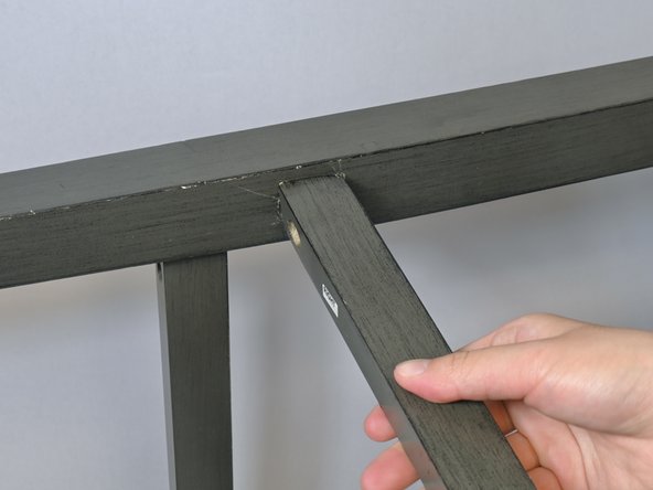

    • Align the empty stretcher hole to the the leg hole filled with paste.
    • Insert the dowel and firmly push it in till it's fully submerged into the stretcher hole.
    • Insertion of the dowel will push out some of the wood paste.

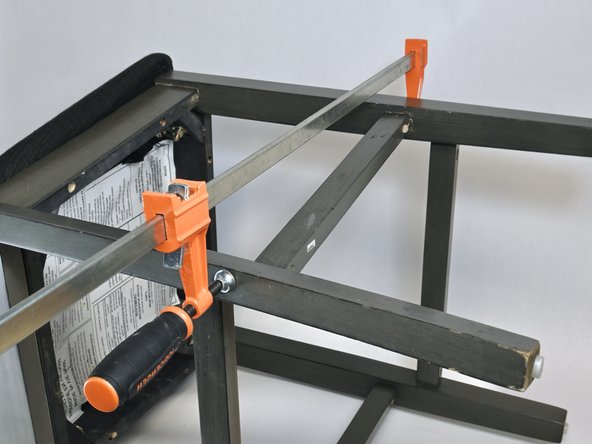

    • Put the legs holding the stretcher between the bar clamp's jaws.
    • Screw in the handle to clamp together the legs until it is secure.
    • Putting a cloth or barrier between the clamp and the leg can prevent possible damage to the wood's surface.

    • Leave the chair and bar clamp in place for 24 hours while the wood glue and paste cures.
    • After waiting, screw out the clamp's handle to remove it from the chair.
