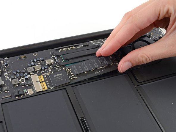

    5. How to Recover Data From a MacBook, External Hard Drive Enclosure: crwdns2935265:08crwdnd2935265:01crwdnd2935265:03crwdne2935265:0 How to Recover Data From a MacBook, External Hard Drive Enclosure: crwdns2935265:08crwdnd2935265:02crwdnd2935265:03crwdne2935265:0 How to Recover Data From a MacBook, External Hard Drive Enclosure: crwdns2935265:08crwdnd2935265:03crwdnd2935265:03crwdne2935265:0
      • If your MacBook contains a removable hard drive you can use an enclosure to house the hard drive and connect it to another Mac to extract the data.
      • Use the Hard Drive Replacement Guide for your model to extract the drive.
      • Various adapters and enclosures are available for the different drive form factors. Be sure to read the fine print to ensure your drive will function. Even if it fits, it may not be compatible.
      • Enclosure for 2.5" SATA style hard drives.
      • Enclosure for early blade style SSDs
      • Enclosure for newer blade style SSDs
      • If your MacBook is a 2016 Pro or a 2018 Air or newer, storage will likely be soldered to the board and cannot be extracted in this way.
      • The 2016-2017 Function Keys MacBook Pro does have a removable drive, but adapters are not available. To extract data you will need to install the drive into a similar MacBook.

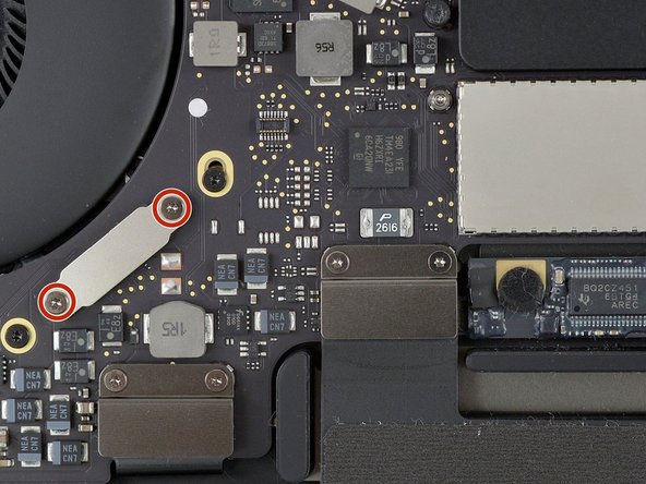

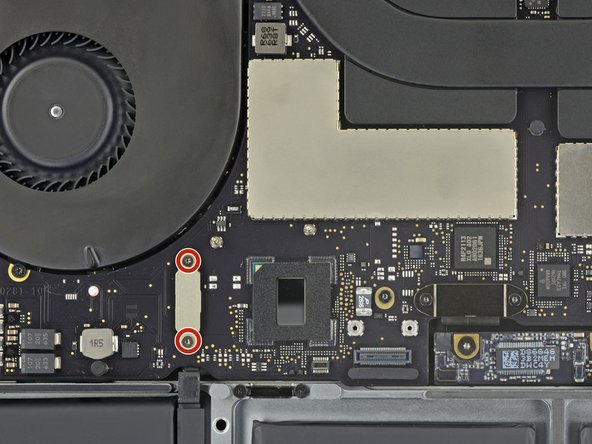

    7. How to Recover Data From a MacBook, Using the Customer Migration Tool: crwdns2935265:010crwdnd2935265:01crwdnd2935265:03crwdne2935265:0 How to Recover Data From a MacBook, Using the Customer Migration Tool: crwdns2935265:010crwdnd2935265:02crwdnd2935265:03crwdne2935265:0 How to Recover Data From a MacBook, Using the Customer Migration Tool: crwdns2935265:010crwdnd2935265:03crwdnd2935265:03crwdne2935265:0
      • Disconnect the battery for the machine whose data needs extraction.
      • Remove the two T3 screws holding in the LifeBoat Connector. Note the slightly different locations of the port on the 13" versus the 15" models.
      • The tool itself consists of a box with three points of connection. One for power, one to tap into the faulty logic board, and one to connect the faulty board to a known good Mac for data transfer.
      • Connect the cable to the open port on the Mac in need of data extraction and then Thunderbolt cable to the destination or conduit Mac before connecting the power cable to the Migration Tool.
      • If the storage is functional on the Mac, it will appear on the good Mac as an external drive.

If you are able to find and use Apple's Customer Data Migration tool, be aware that there might be issues connecting it to anything running a later version of macOS.
Apple does not have any documentation on this for service technicians, but I ran headlong into that scenario this afternoon -- I could not get the CDM to connect to a Mac running macOS 15, and thinking about the security warnings for peripherals (though I did not see any option to allow a device to connect) my curiosity led me to try macOS 14 (without success), and then macOS 13, and that worked.
There might be some sort of Terminal command that could release the security for peripherals that would allow the CDM to connect, but if all else fails, try a device running an older version of macOS.
registration - crwdns2934203:0crwdne2934203:0 crwdns2950251:0crwdne2950251:0
Thanks for this info!
I am not surprised. Any device that uses the lifeboat connector would have been from 2016 or 2017 and all of those devices are end of life by Apple's standards. Nothing newer than Ventura is officially supported on those. So justification to not continue support for those tools.
