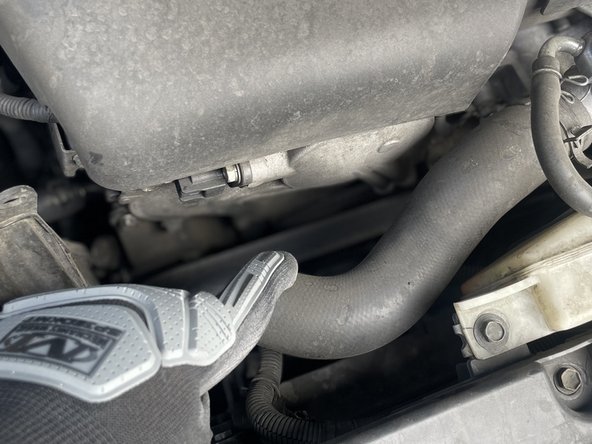

    • Locate the high and low-pressure ports.
    • The high-pressure port is located on the upper right (below the brake liquid).
    • The low-pressure port is located inside the brake liquid case (remove the case).

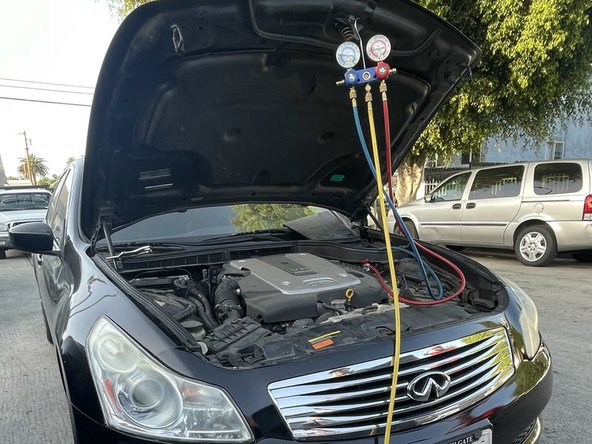

    • Connect the hoses to the gauge and the pressure ports.
    • Blue stands for low pressure.
    • Red stands for high pressure.
    • Yellow is where the new air flows through the two hoses.

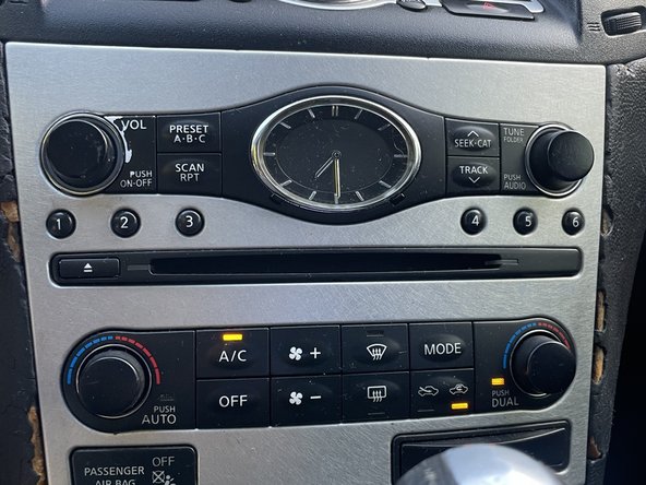

    • Turn on the engine.
    • Turn the A/C to the maximum capacity.
    • Make sure the pulley belt is spinning smoothly to proceed.

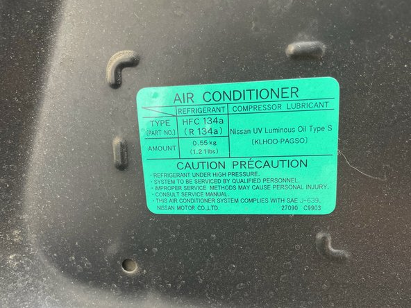

    • Pump the refrigerant until the pressure gauge gets to 25- 45 psi. This process can take 10 minutes.
    • Do not go past 45 psi as the car can over-charge.
    • If you are using refrigerant mini cans, use the amount the car recommends. You can find this information inside the hood of the vehicle.

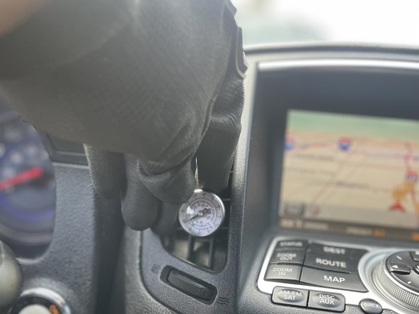

    • Go inside your vehicle and check the temperature.
    • The temperature should be from 35-48 degrees Fahrenheit.
    • If the temperature is over what is recommended, the A/C will just be really cold. This will cause no problems.
