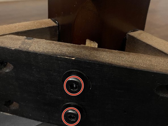

    • Carefully place the table on an even surface and identify the broken parts.
  2. How to Reattach a Broken Table Leg: crwdns2935265:02crwdnd2935265:01crwdnd2935265:01crwdne2935265:0
    • Carefully place the table with the tabletop face down on a clean cloth or plastic cover to prevent scratching.
    • You might need some assistance depending on the size of the table.
  3. How to Reattach a Broken Table Leg: crwdns2935265:03crwdnd2935265:01crwdnd2935265:02crwdne2935265:0 How to Reattach a Broken Table Leg: crwdns2935265:03crwdnd2935265:02crwdnd2935265:02crwdne2935265:0

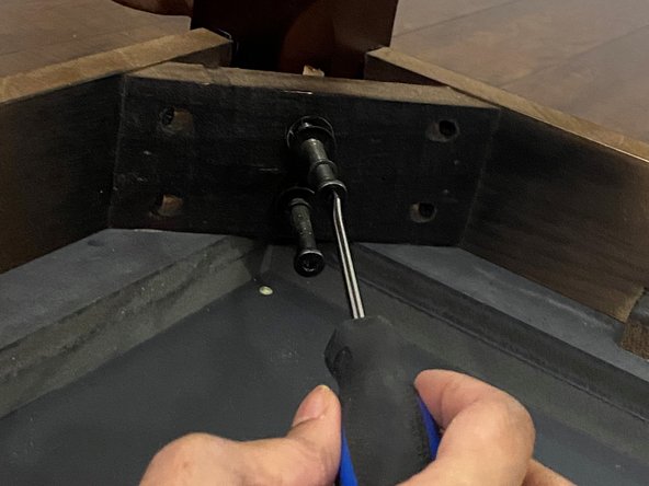

    • Remove the screws from the broken leg.
    • I am using a Mastercraft flathead 3 mm screwdriver in this step. Your screwdriver type will depend on the screw. Follow this guide to learn more about screwdriver types.
    • Remove the broken leg.
