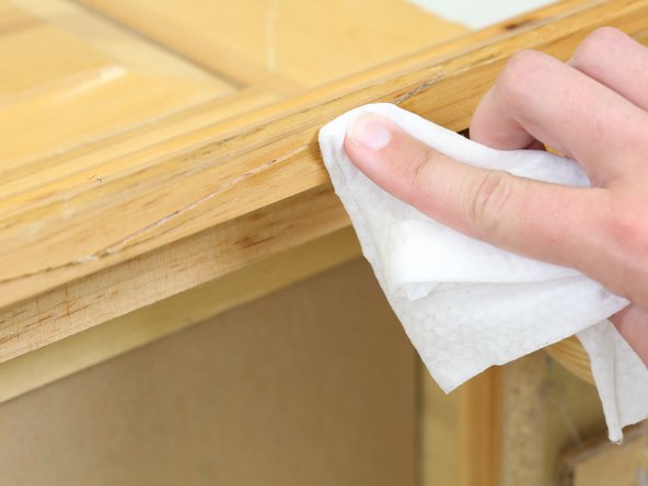

    • Dust the surface of the fragment and the damaged area of the furniture.
    • Any household cleaner will work; we recommend a damp rag.
    • Clean carefully, making sure not to cause further damage by splintering the fragment.

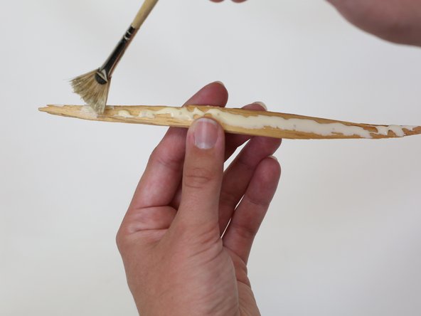

    • Apply glue to both the fragment and the furniture.
    • Check that the glue is spread evenly throughout both pieces.
    • Using a brush to spread the glue to all crevices is most effective.

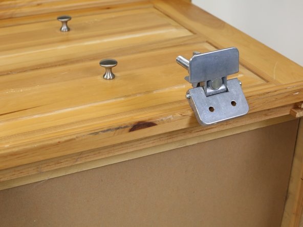

  6. How to Reattach a Broken Piece of Wood: crwdns2935265:06crwdnd2935265:01crwdnd2935265:02crwdne2935265:0 How to Reattach a Broken Piece of Wood: crwdns2935265:06crwdnd2935265:02crwdnd2935265:02crwdne2935265:0
    • Clamp the two pieces together.
    • You can use any type of clamp that you have on hand. If you don't have a clamp, any type of clip would work.
    • Wait 30 minutes for the glue to dry before removing the clamp.
    • Be careful not to bump the fragment out of alignment as you are clamping.
