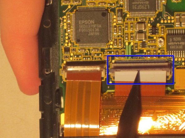

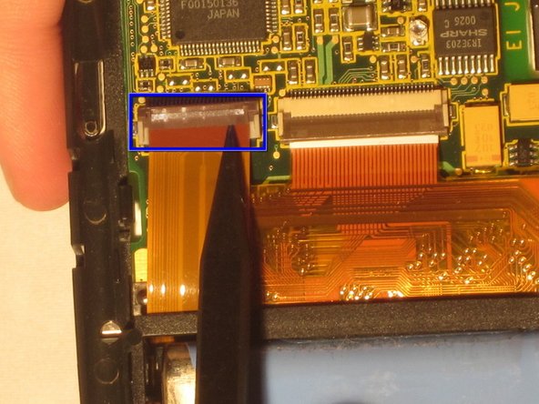

  3. How to Reassemble the Palm IIIc: crwdns2935265:03crwdnd2935265:01crwdnd2935265:03crwdne2935265:0 How to Reassemble the Palm IIIc: crwdns2935265:03crwdnd2935265:02crwdnd2935265:03crwdne2935265:0 How to Reassemble the Palm IIIc: crwdns2935265:03crwdnd2935265:03crwdnd2935265:03crwdne2935265:0
    • Secure the bottom two ZIF connectors into their slots by opening the flap and inserting the ZIF connectors.
    • Gently press down on the flap to secure the ZIF connector. This secures the screen and buttons to the motherboard.

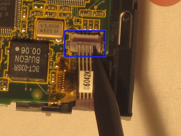

  5. How to Reassemble the Palm IIIc: crwdns2935265:05crwdnd2935265:01crwdnd2935265:02crwdne2935265:0 How to Reassemble the Palm IIIc: crwdns2935265:05crwdnd2935265:02crwdnd2935265:02crwdne2935265:0
    • Open the ZIF connector box at the top of the motherboard by gently pulling up on the flap.
    • Insert the ZIF tab into the connector box.
    • Gently press down on the flap to secure the ZIF tab in place.

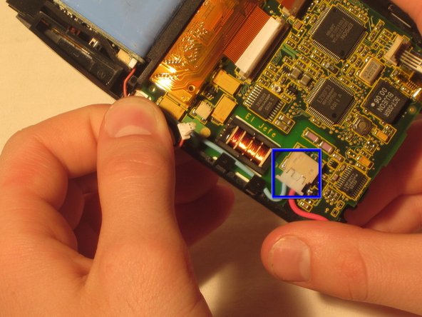

  6. How to Reassemble the Palm IIIc: crwdns2935265:06crwdnd2935265:01crwdnd2935265:01crwdne2935265:0
    • Attach the white box on the end of the red cable connected to the battery into the connector box on the motherboard.
