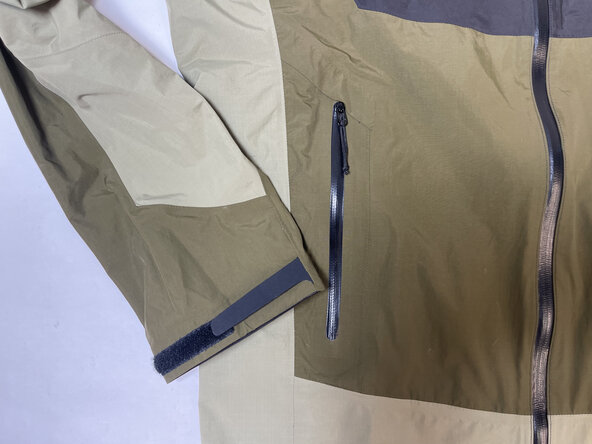

    • Prepare the jacket by loosening velcro straps and closing all zippers.

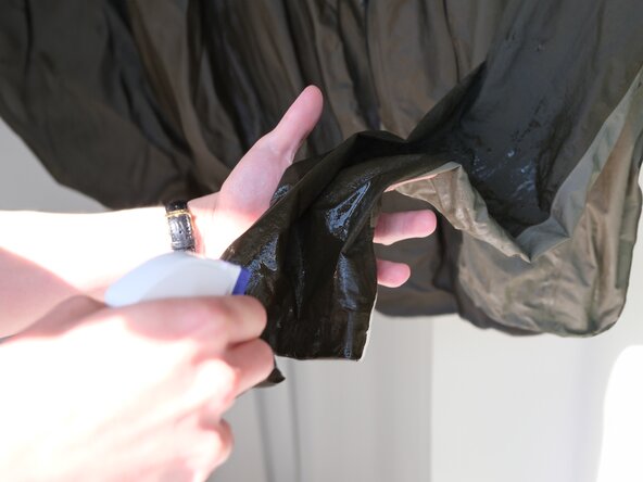

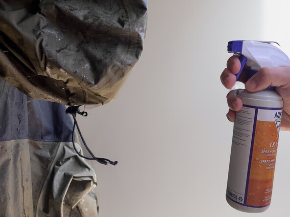

    • After washing the jacket, spray DWR onto the jacket focusing on high stress areas (shoulders, elbows, wrists, chest).

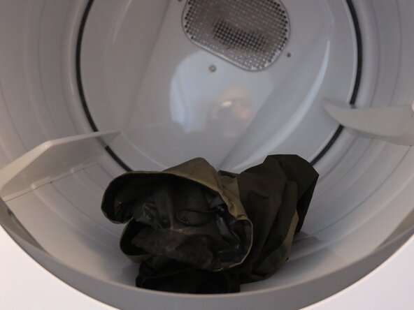

    • Set your dryer to a normal cycle.
    • If still damp do another cycle to ensure DWR has been activated.
