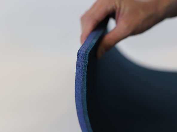

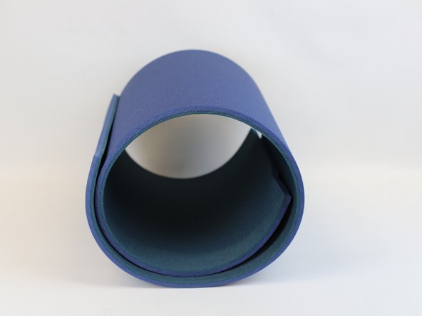

  1. How to Re-attach Delaminated Layers on a Foam Camping Mat, Identify the repair area: crwdns2935265:01crwdnd2935265:01crwdnd2935265:03crwdne2935265:0 How to Re-attach Delaminated Layers on a Foam Camping Mat, Identify the repair area: crwdns2935265:01crwdnd2935265:02crwdnd2935265:03crwdne2935265:0 How to Re-attach Delaminated Layers on a Foam Camping Mat, Identify the repair area: crwdns2935265:01crwdnd2935265:03crwdnd2935265:03crwdne2935265:0
    • Locate the delaminated part that needs to be fixed.
    • Choose a suitable glue that adheres to foam surfaces.
    • Note: in this example, we choose a spray glue, but any foam-adapted glue will work just the same.

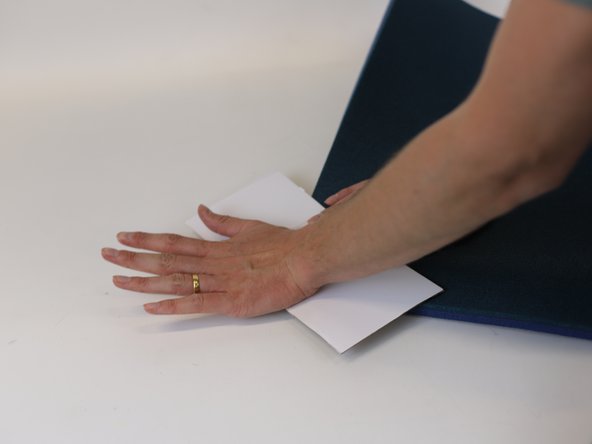

  2. How to Re-attach Delaminated Layers on a Foam Camping Mat, Prepare the area for spraying: crwdns2935265:02crwdnd2935265:01crwdnd2935265:03crwdne2935265:0 How to Re-attach Delaminated Layers on a Foam Camping Mat, Prepare the area for spraying: crwdns2935265:02crwdnd2935265:02crwdnd2935265:03crwdne2935265:0 How to Re-attach Delaminated Layers on a Foam Camping Mat, Prepare the area for spraying: crwdns2935265:02crwdnd2935265:03crwdnd2935265:03crwdne2935265:0
    • Place a piece of paper or old newspaper under the mat to protect the surface before spraying.
    • Tip: leave a distance of 20-30 cm around the mat when spraying.
    • Place a small piece of cardboard between the tip and the rest of the mat to prevent the spray glue from directly staining it.

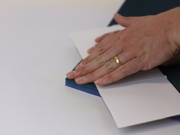

  3. How to Re-attach Delaminated Layers on a Foam Camping Mat, Apply the glue: crwdns2935265:03crwdnd2935265:01crwdnd2935265:02crwdne2935265:0 How to Re-attach Delaminated Layers on a Foam Camping Mat, Apply the glue: crwdns2935265:03crwdnd2935265:02crwdnd2935265:02crwdne2935265:0
    • Spray the delaminated area with the foam glue.

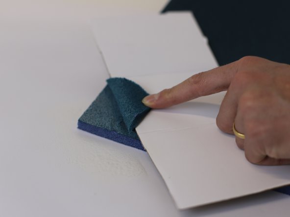

  4. How to Re-attach Delaminated Layers on a Foam Camping Mat, Secure the attachment: crwdns2935265:04crwdnd2935265:01crwdnd2935265:03crwdne2935265:0 How to Re-attach Delaminated Layers on a Foam Camping Mat, Secure the attachment: crwdns2935265:04crwdnd2935265:02crwdnd2935265:03crwdne2935265:0 How to Re-attach Delaminated Layers on a Foam Camping Mat, Secure the attachment: crwdns2935265:04crwdnd2935265:03crwdnd2935265:03crwdne2935265:0
    • Apply pressure to the area.
    • Note: Follow the instructions of the glue used to know the exact drying time. In this example, we waited 1 minute for the glue to dry before attaching both layers together. Afterwards, we held the parts together for 3 minutes and then let it dry overnight.
