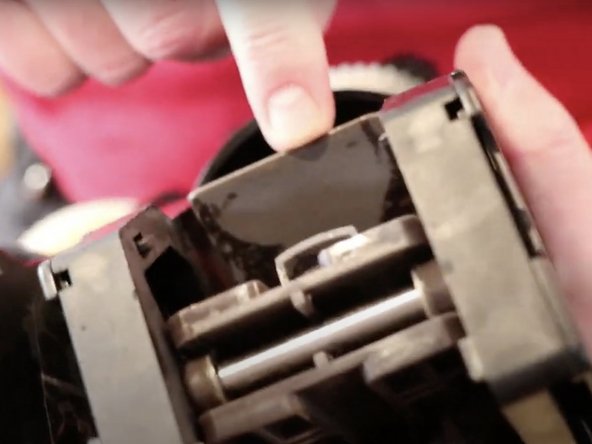

    • Overnight Care: Leave the machine’s drawer for coffee grounds slightly open overnight or during extended periods of non-use to prevent mold growth.

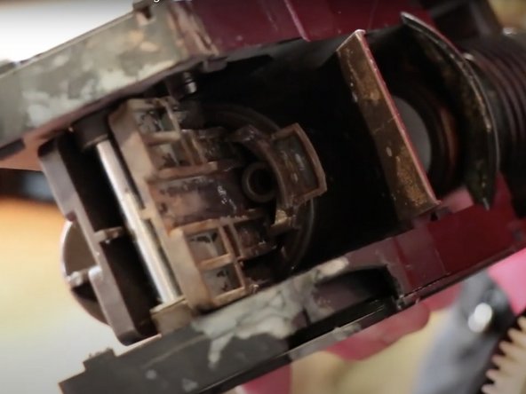

    • If you suspect mold in hard-to-reach areas, you'll need to open the machine. You'll find guides on how to do that in the subcategory of your model, here's one example: Saeco Minuto öffnen
