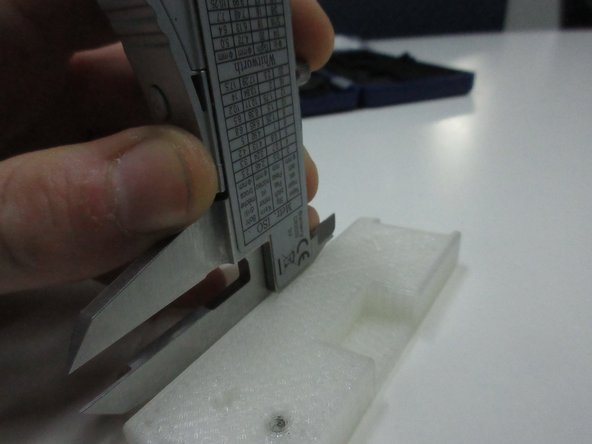

    • Use the metal wheel contacting the measured surfaces.
    • This will allow for a more repeatable measurement.
    • Extend the calibration life of the device. Preventing damage to the measuring surfaces or measured part.
    • Make use of the locking mechanism.
    • Occasionally the device has to be positioned in a way that cannot be read.
    • Always prioritize comfort. If there is a change the jaws can move when attempting to read. Lock the device. Move it to you.
    • Ensure the part is secure, use flat surfaces, try to use the vernier comfortably with both hands.

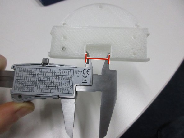

  2. How to Position a Vernier Caliper, External Feature: crwdns2935265:02crwdnd2935265:01crwdnd2935265:03crwdne2935265:0 How to Position a Vernier Caliper, External Feature: crwdns2935265:02crwdnd2935265:02crwdnd2935265:03crwdne2935265:0 How to Position a Vernier Caliper, External Feature: crwdns2935265:02crwdnd2935265:03crwdnd2935265:03crwdne2935265:0
    • External features are measured as shown.
    • These sections of the jaws have a knife edge,
    • Used to measure smaller features with low clearances.
    • These sections have a flat edge.
    • Used to measure larger features with perpendicular surfaces.

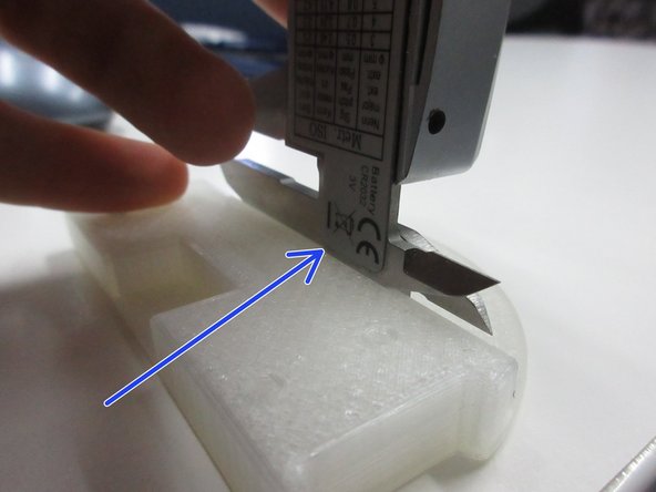

  3. How to Position a Vernier Caliper, Internal Feature: crwdns2935265:03crwdnd2935265:01crwdnd2935265:01crwdne2935265:0
    • Internal features are measured as shown.

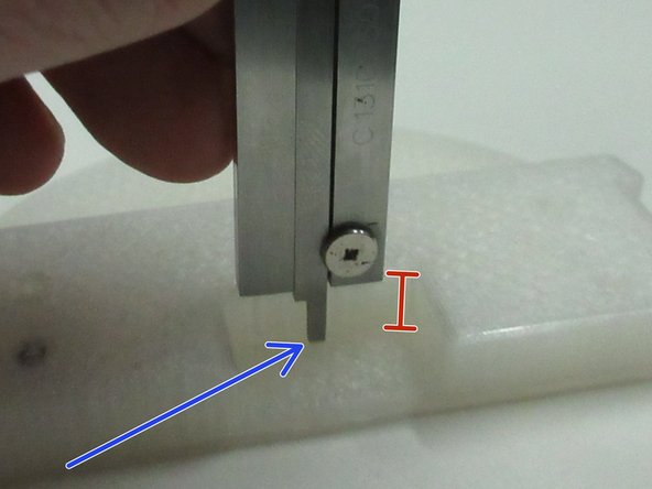

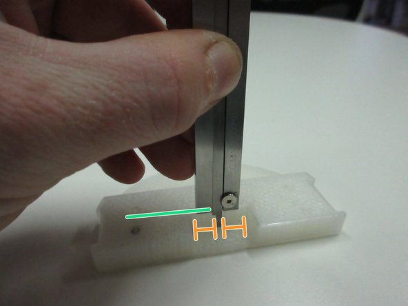

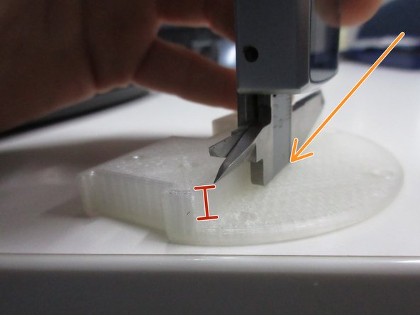

  4. How to Position a Vernier Caliper, Height: crwdns2935265:04crwdnd2935265:01crwdnd2935265:03crwdne2935265:0 How to Position a Vernier Caliper, Height: crwdns2935265:04crwdnd2935265:02crwdnd2935265:03crwdne2935265:0 How to Position a Vernier Caliper, Height: crwdns2935265:04crwdnd2935265:03crwdnd2935265:03crwdne2935265:0
    • Heights of steps are measured as shown.
    • Butt the head of the caliper against one surface.
    • Butt the head of the slider against the other surface.
