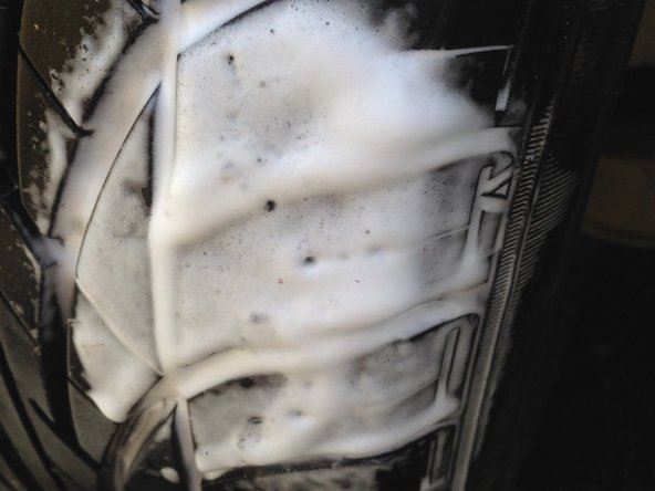

      • Window cleaner or soapy water sprayed on the tire is a quick method for identifying the location of a leak. Always check the valve stem in addition to the tire itself.
      • For a plug to be safe and work, the repair must be inside the main tread area, and not on the edge of the tread or sidewall.

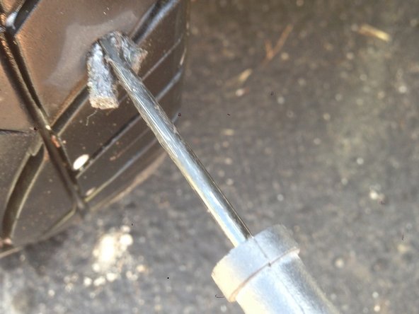

      • Insert 90% of the plug into the tire, leaving just short ends exposed.
      • Pull the needle out slowly, leaving the plug in the tire.

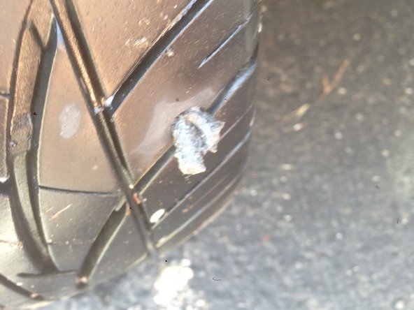

    5. How to Plug a Tire: crwdns2935265:05crwdnd2935265:01crwdnd2935265:03crwdne2935265:0 How to Plug a Tire: crwdns2935265:05crwdnd2935265:02crwdnd2935265:03crwdne2935265:0 How to Plug a Tire: crwdns2935265:05crwdnd2935265:03crwdnd2935265:03crwdne2935265:0

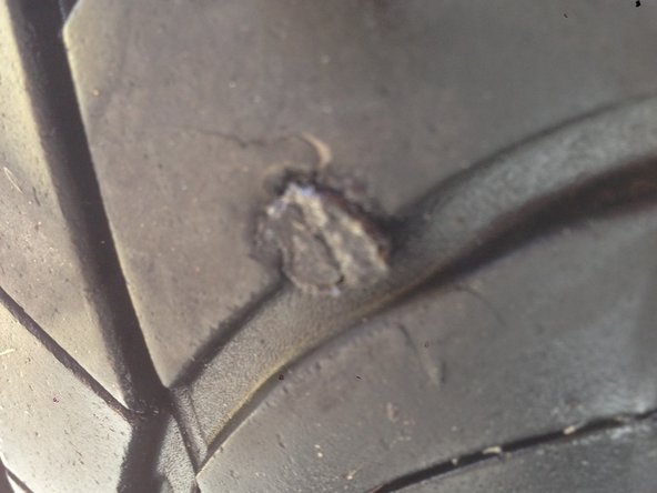

      • Trim the plug ends flush with the tire.
      • Recheck for leaks with window cleaner or soapy water.
      • Reset your tire pressure to the correct specification for your vehicle.
