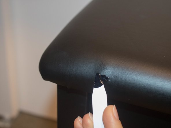

    • Clean the damaged area with rubbing alcohol, using a rag, paper towel, or Q-tip.
  2. How to Patch a Tear in Vinyl Furniture: crwdns2935265:02crwdnd2935265:01crwdnd2935265:01crwdne2935265:0
    • Cut the backing fabric large enough to cover the tear, approximately half an inch larger around the tear.
  3. How to Patch a Tear in Vinyl Furniture: crwdns2935265:03crwdnd2935265:01crwdnd2935265:02crwdne2935265:0 How to Patch a Tear in Vinyl Furniture: crwdns2935265:03crwdnd2935265:02crwdnd2935265:02crwdne2935265:0
    • Use the spatula tool to insert the backing fabric underneath the tear.
  4. How to Patch a Tear in Vinyl Furniture: crwdns2935265:04crwdnd2935265:01crwdnd2935265:02crwdne2935265:0 How to Patch a Tear in Vinyl Furniture: crwdns2935265:04crwdnd2935265:02crwdnd2935265:02crwdne2935265:0
    • Use the spatula to apply the adhesive to the damaged area.
    • Choose a color that matches your furniture. You may need to mix colors to acheive the correct shade.
  5. How to Patch a Tear in Vinyl Furniture: crwdns2935265:05crwdnd2935265:01crwdnd2935265:01crwdne2935265:0
    • Let the adhesive dry for approximately four hours.
    • You may use a hair dryer to speed up the drying process.
  6. How to Patch a Tear in Vinyl Furniture: crwdns2935265:06crwdnd2935265:01crwdnd2935265:02crwdne2935265:0 How to Patch a Tear in Vinyl Furniture: crwdns2935265:06crwdnd2935265:02crwdnd2935265:02crwdne2935265:0
    • Use a Q-tip dipped in rubbing alcohol to buff and blend the area.
    • Apply light pressure to even out the edges.
Once the adhesive is dry, the furniture is ready for use!
