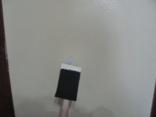

  4. How to Patch a Small Hole in Drywall: crwdns2935265:04crwdnd2935265:01crwdnd2935265:03crwdne2935265:0 How to Patch a Small Hole in Drywall: crwdns2935265:04crwdnd2935265:02crwdnd2935265:03crwdne2935265:0 How to Patch a Small Hole in Drywall: crwdns2935265:04crwdnd2935265:03crwdnd2935265:03crwdne2935265:0
    • Remove the painters tape from the wall.
    • Dip the paint sponge in paint, and paint the wall with the original color of the wall.
    • Let it dry accordingly.
