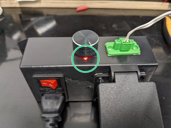

  1. How to Operate the Timer Relay Box, Power the box: crwdns2935265:01crwdnd2935265:01crwdnd2935265:02crwdne2935265:0 How to Operate the Timer Relay Box, Power the box: crwdns2935265:01crwdnd2935265:02crwdnd2935265:02crwdne2935265:0
    • Connect the box to the mains power using an IEC C13 cable (kettle cable)
    • Check the switch is turned on.
    • Wait a few seconds, the LED under the knob will hold green to indicate the system is operating.

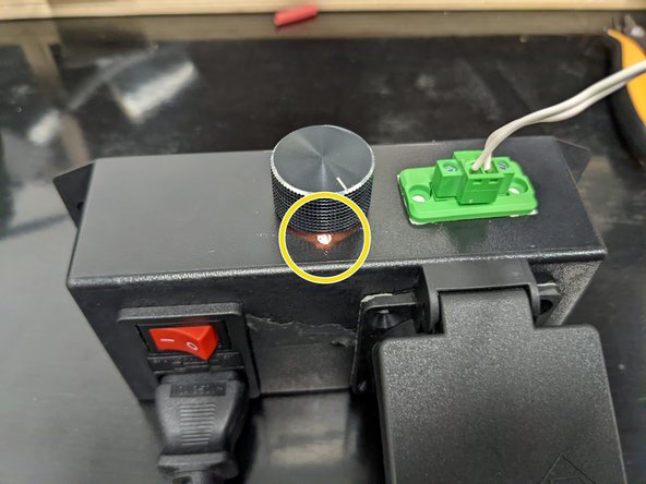

  7. How to Operate the Timer Relay Box, Operate the Timer Box: crwdns2935265:07crwdnd2935265:01crwdnd2935265:03crwdne2935265:0 How to Operate the Timer Relay Box, Operate the Timer Box: crwdns2935265:07crwdnd2935265:02crwdnd2935265:03crwdne2935265:0 How to Operate the Timer Relay Box, Operate the Timer Box: crwdns2935265:07crwdnd2935265:03crwdnd2935265:03crwdne2935265:0
    • Once calibrated, the timer box will switch to operation mode.
    • The LED will hold green when the box is waiting to be triggered.
    • The Box can be triggered through the button wires, or the encoder button
    • Once triggered, the LED will turn amber for the initial delay
    • The LED will turn RED when the equipment is being powered.
    • The LED will return to green once the system is ready to be triggered again.
