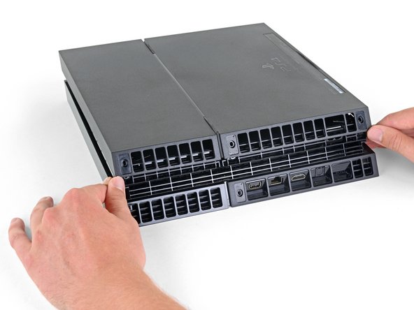

  4. How to Open and Clean a PlayStation 4, Remove the lower case: crwdns2935265:04crwdnd2935265:01crwdnd2935265:02crwdne2935265:0 How to Open and Clean a PlayStation 4, Remove the lower case: crwdns2935265:04crwdnd2935265:02crwdnd2935265:02crwdne2935265:0
    • Use your thumbs to lift the lower case up and off the PS4.
    • In addition to the three rear screws, the lower case is held in place by plastic clips. You may need to use significant force to release the lower case.

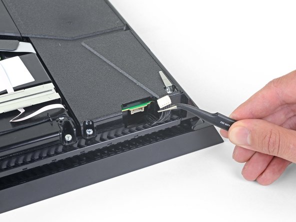

  5. How to Open and Clean a PlayStation 4, Disconnect the power supply: crwdns2935265:05crwdnd2935265:01crwdnd2935265:02crwdne2935265:0 How to Open and Clean a PlayStation 4, Disconnect the power supply: crwdns2935265:05crwdnd2935265:02crwdnd2935265:02crwdne2935265:0
    Small Needle Nose Pliers
    $6.99
    • Use a pair of tweezers to pull the power supply cable straight out to disconnect the power supply unit from the motherboard.
    • Depending on the age of your console, this cable might be very firmly connected. If it feels stuck, don't pull on the cables themselves with much force.
    • Use your fingers to grab the white connector head, and wiggle or "walk" the connector out of its socket to disconnect it.
    • In extreme cases, you might need to use needle nose pliers to get a good grip on the connector.
    • Go slow: pulling on the cables themselves might rip them out of the connector.

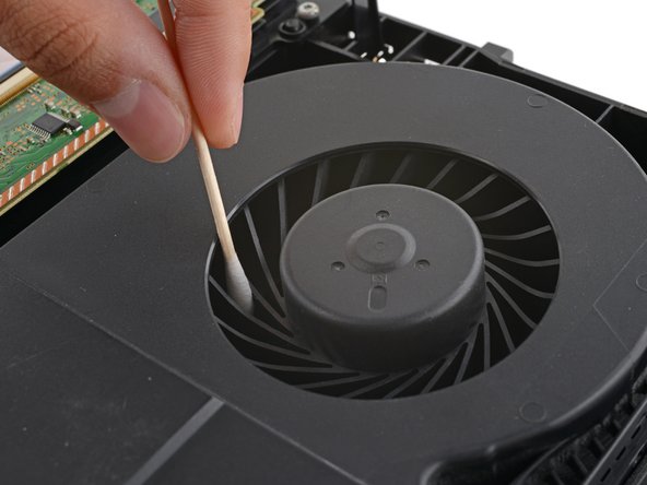

  8. How to Open and Clean a PlayStation 4, Clean the fan: crwdns2935265:08crwdnd2935265:01crwdnd2935265:02crwdne2935265:0 How to Open and Clean a PlayStation 4, Clean the fan: crwdns2935265:08crwdnd2935265:02crwdnd2935265:02crwdne2935265:0
    Dust Blower
    $19.99
    • Over time, dust will build up inside the fan and on the fan blades.
    • Use a pair of tweezers to grab loose hairs and dust clumps off the fan.
    • Use a small dust blower or light compressed air to blow remaining dust off the fan.
    • Use a finger to keep the fan blades steady—it makes them easier to clean.
    • If there's a layer of grime on the fan blades, use soapy water or isopropyl alcohol on a cotton swab to wipe them off.

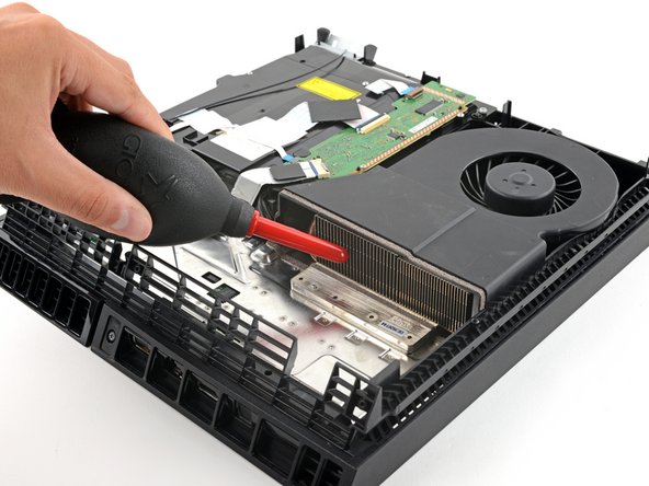

  11. How to Open and Clean a PlayStation 4, Clean the heatsink: crwdns2935265:011crwdnd2935265:01crwdnd2935265:02crwdne2935265:0 How to Open and Clean a PlayStation 4, Clean the heatsink: crwdns2935265:011crwdnd2935265:02crwdnd2935265:02crwdne2935265:0
    • The PS4 draws air through the heatsink fins, and they may clog with dust and debris over time.
    • If you can see dust buildup in the heatsink, dislodge debris with a brush and use a dust blower to blow it clean.
    • Remember: use this time to clean any other dirty internal surfaces before you reseal your console. Happy gaming!
