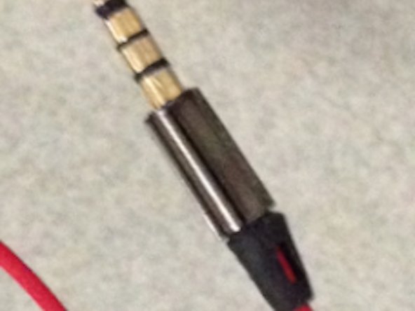

    • Pull the cable off from the 3.5mm headphone jack. You may use heat-gun to make it warm. Be careful not to make it too hot. Keep focusing to make the base of the jack warmer not the divided end or the nose of the jack.
    • If you headphone cable and wires are already pulled off, warm up longer to the base of the jack and then using pointer pliers, try to pull off gently without tearing the cable/wire support rubber stuff apart. This is the thing that enhances the look and support of the cable to the iBeats metal exterior for 3.5mm jack.
  2. How to Monster iBeats: crwdns2935265:02crwdnd2935265:01crwdnd2935265:03crwdne2935265:0 How to Monster iBeats: crwdns2935265:02crwdnd2935265:02crwdnd2935265:03crwdne2935265:0 How to Monster iBeats: crwdns2935265:02crwdnd2935265:03crwdnd2935265:03crwdne2935265:0
    • Cut the White wire at 2cm, Green wire at 3cm, Red wire at 4cm and Yellow wire at 5cm length respectively from the edge of the cable.
    • Then, pre-solder the wire to get it ready to solder to the 3.5mm jack's required 4 apparent spots. Place the jack as trapped between the jaws of the flat pliers securely. You may hold the hands of the pliers simply by rubber band or a peace of nylon or clothes.
    • Then solder the shortest wire to the finish end of the jack (the thinnest soldering end), which is the White wire. And so on until the Yellow wire being soldered to the wider edge of the jack. Remember, you should solder just a tiny bit, not much, and the best way possible. Do it as much polished way as possible since the iBeats metal exterior is not flexible and has a very limited space. Examine it before soldering closely.

    • Now push the jack into the iBeats metal exterior spraying quick dry fixer inside the metal exterior so that once the jack is inserted, it resides there firmly. Then push the Rubber Cable Support piece into the other end of the metal exterior the same way.
    • If you observe the picture closely, you may see a little gap between the cable holder and iBeats metal exterior. If you spray quick fixer well and pushed hart, you not gonna see that gap any more and your iBeats will look seamed properly. This will give your work a professional or refined look and feel.

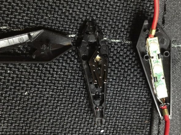

    • We just finished repairing, the defective 3.5mm headphone jack part. Now we are repairing the ControlTalk button that has malfunctioned due to broken circuit or broken one of the wires inside the ControlTalk compartment.

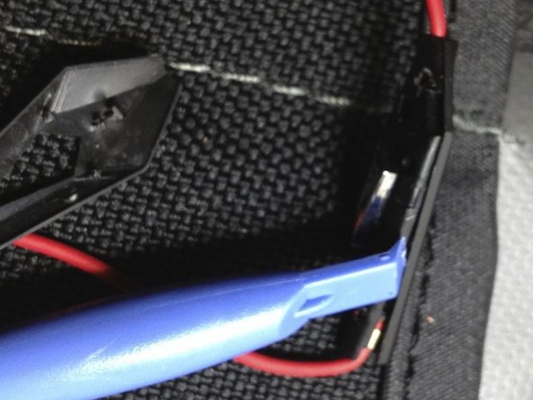

    • Let's begin. Pull of the Talk pane off using a plastic spade or opening tool by lifting it gently up. Then pull off the middle part carefully. You should be very careful here because ControlTalk compartment doesn't have any external screws or binders to hold this thing. Only the inbuilt tinny aligns that hold it together. They are really fragile and break easily.
    • Once you reach the base where you will see the circuit board, examine if there is a broken circuit. Look carefully. Take your time. Don't just jump to the conclusion. It may just have circuit broken or just the wire come off or both. Or just the talk responser is stiffen with excess moisture and dust. Diagnose the case and do accordingly.
    • Common scenario is either broken circuit or wire. Solder the circuit carefully if such is the case. If White wire or any of the wires is apart from the designated points, solder it carefully. A little excess soldering will melt the neighboring elements. If you accidentally dropped or soldered on the plate and incorrectly, be very patient to take it apart securely. A little shake may destroy the whole plate or pull off the elements. Stay focused during this process.

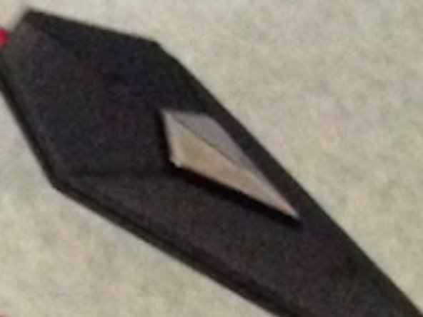

    • Once you align the middle cover on top of the ControlTalk board, you are almost done. Simply put the last piece of top of it and press gently to hear the light clip sound. That is it. Careful alignment gives the same feel and look of your ControlTalk as was before. Nobody will notice that you operated this little thing for repair purpose.
    • Once you place the top tab on, it should look comfortably aligned to the base. A little wider opening is an error or the setup is not 100% well done. This is critical. But it can be fixed. Open the first cover on top, and then see if its tinny tabs of the base are standing properly. If not, you have to try to straighten it. You can use crazy glue kind of stuff to affix it back. But do not use such material directly to the shell. Only the tabs should hold and align the exterior.
