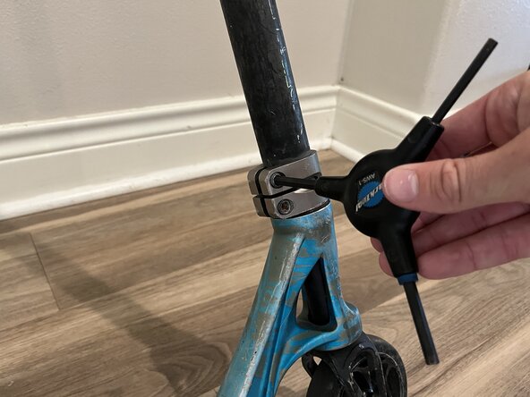

    • Use a 6 mm Allen wrench to loosen the clamp screws
    • Do not remove the bolts—loosening them slightly is enough to free the bars.
    • Lift the handlebars straight up and off the fork.
    • If the bars are stuck, gently wiggle or tap them until they release.
    • It may take some force to remove the bars. Keep at them until they come off.

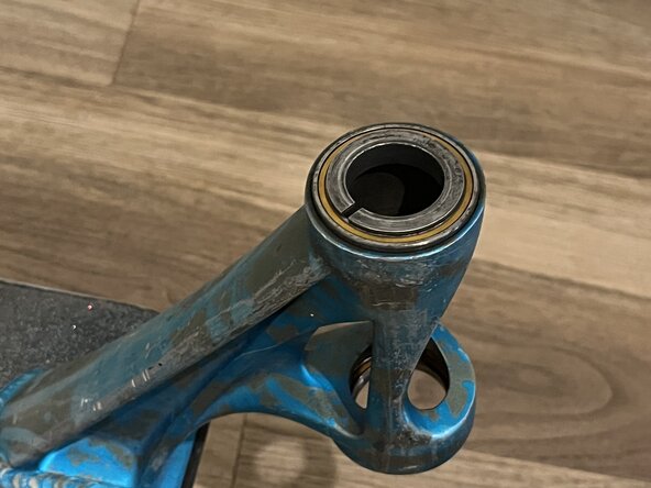

  3. How to Maintain an Envy Prodigy Headset: crwdns2935265:03crwdnd2935265:01crwdnd2935265:03crwdne2935265:0 How to Maintain an Envy Prodigy Headset: crwdns2935265:03crwdnd2935265:02crwdnd2935265:03crwdne2935265:0 How to Maintain an Envy Prodigy Headset: crwdns2935265:03crwdnd2935265:03crwdnd2935265:03crwdne2935265:0
    • Remove the bearings from the deck tube.
    • Inspect each bearing for signs of rust or damage.
    • Wipe down both the deck tube and the bearings to remove dirt or moisture.
    • Apply a thin, even layer of bearing lubricant to the headset cups, bearing surfaces, and steerer tube before reassembly to reduce friction and prevent corrosion.
    • Reinsert the bearings into the deck tube.
    • They will snap back in place the same way they were removed.
