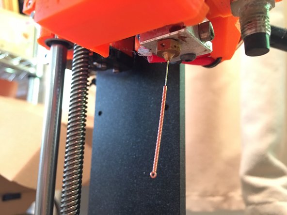

    • In addition to regular, scheduled maintenance of a 3D printer, occasionally it may be necessary to perform some additional maintenance
    • If you are experiencing layer shifts; check all motors, belts, and pulleys are able to be moved freely and are not obstructed.
    • If the x, y, or z axis doesn't move easily and freely and the printer is sensing crashes you may add a small dot of lithium grease on the smooth rods, which will be incorporated into the bearings during use.
    • If the nozzle is clogged, you may need to clear the nozzle orifice with an acupuncture needle
    • Caution: A hot nozzle is a burn hazard, do not touch it with your hands.
    • Before, during, and after every print, check the condition of the fans and ensure they are not obstructed. The printer will not work if the fans are detected to be faulty.
