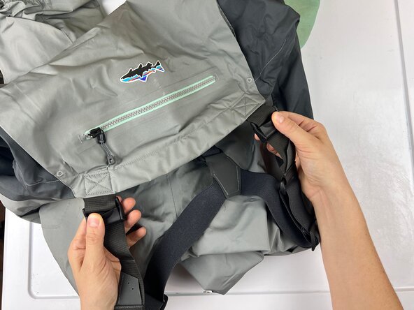

  1. How to Machine Wash a Wader, Prepare the wader: crwdns2935265:01crwdnd2935265:01crwdnd2935265:02crwdne2935265:0 How to Machine Wash a Wader, Prepare the wader: crwdns2935265:01crwdnd2935265:02crwdnd2935265:02crwdne2935265:0

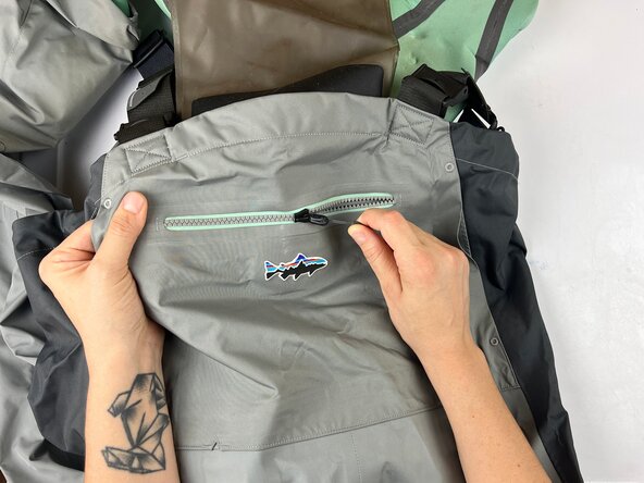

    • Shake off any excess dirt, zip all zippers, and remove any detachable parts like waistbands or belts.

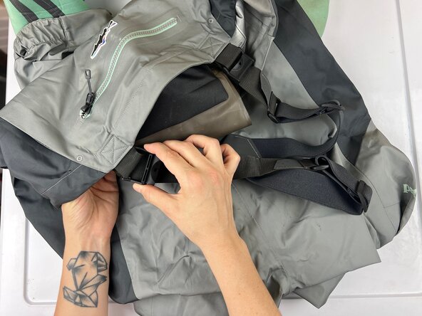

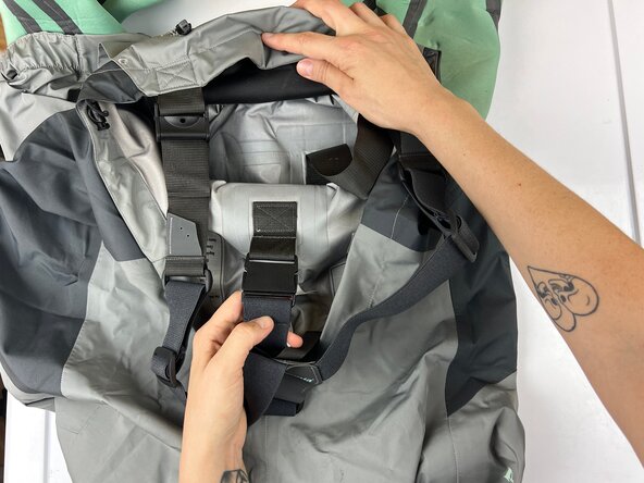

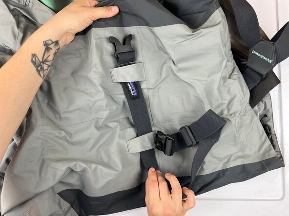

  2. How to Machine Wash a Wader, Secure the straps and fasteners: crwdns2935265:02crwdnd2935265:01crwdnd2935265:03crwdne2935265:0 How to Machine Wash a Wader, Secure the straps and fasteners: crwdns2935265:02crwdnd2935265:02crwdnd2935265:03crwdne2935265:0 How to Machine Wash a Wader, Secure the straps and fasteners: crwdns2935265:02crwdnd2935265:03crwdnd2935265:03crwdne2935265:0
    • Untangle any straps.
    • Close or clip any fasteners or buckles.

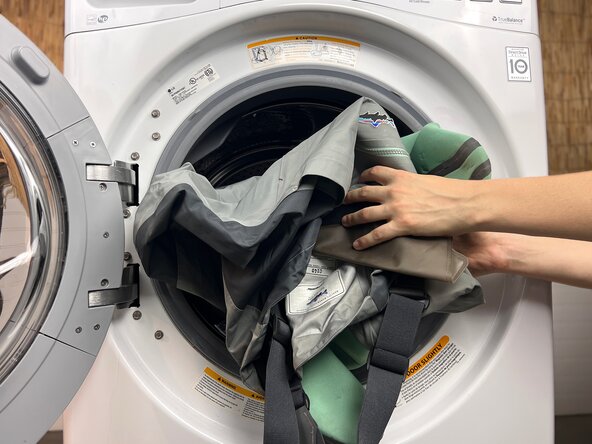

  3. How to Machine Wash a Wader, Load the washing machine: crwdns2935265:03crwdnd2935265:01crwdnd2935265:02crwdne2935265:0 How to Machine Wash a Wader, Load the washing machine: crwdns2935265:03crwdnd2935265:02crwdnd2935265:02crwdne2935265:0
    • Put your waders in the washing machine.

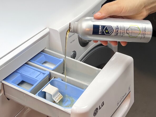

    • Add detergent to the washing machine. You can use special technical gear soap or gentle laundry detergent.
    • Avoid detergent containing fabric softeners, stain removers, perfumes, whiteners, or bleach.

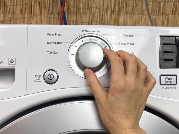

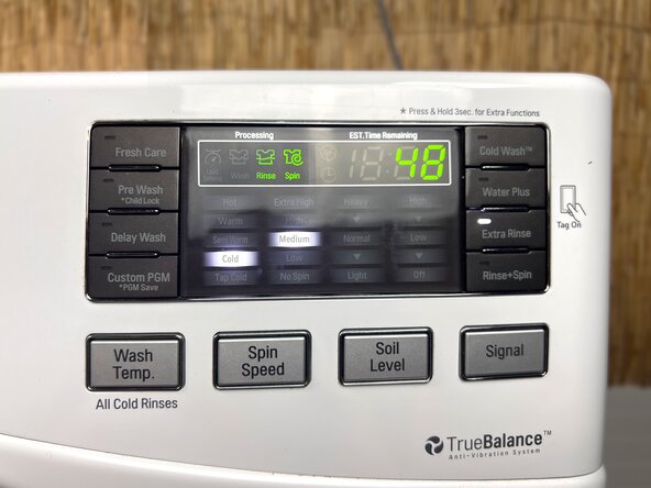

  4. How to Machine Wash a Wader, Set the washing machine: crwdns2935265:04crwdnd2935265:01crwdnd2935265:02crwdne2935265:0 How to Machine Wash a Wader, Set the washing machine: crwdns2935265:04crwdnd2935265:02crwdnd2935265:02crwdne2935265:0
    • Set the load size to small.
    • Set the water temperature to cold.
    • Set the wash cycle to normal or gentle/delicate/permanent press. If possible, add an extra rinse cycle to ensure all residues are removed.
    • Set the spin cycle to low.
    • Start the washing machine.

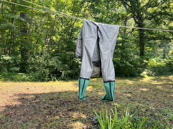

  5. How to Machine Wash a Wader, Dry the waders: crwdns2935265:05crwdnd2935265:01crwdnd2935265:03crwdne2935265:0 How to Machine Wash a Wader, Dry the waders: crwdns2935265:05crwdnd2935265:02crwdnd2935265:03crwdne2935265:0 How to Machine Wash a Wader, Dry the waders: crwdns2935265:05crwdnd2935265:03crwdnd2935265:03crwdne2935265:0

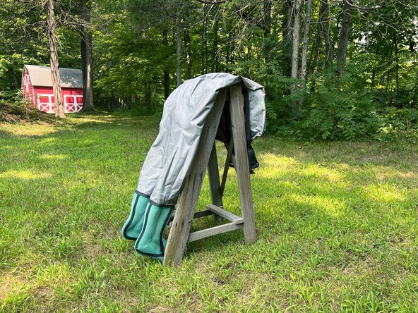

    • Let your waders drip dry as soon as possible by hanging them somewhere and letting excess water drip off.
    • Air dry the inside of your waders by turning them inside-out and hanging them in a shaded, well-ventilated area until the inside is completely dry.
    • You can do this outdoors or in the area where you plan to store them. Laundry lines, ladders, and trees are all great options for air drying. This may take up to 24 hours.

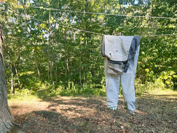

    • Air dry the outside of your waders by turning them right-side-out and hanging them in a shaded, well-ventilated area until the outside is completely dry.
    • Store your waders properly by hanging them by the shoulder straps or on a specialty wader hanger in a well-ventilated storage space.
    • Avoid using a dryer unless the waders have been deeply cleaned with soap first.
