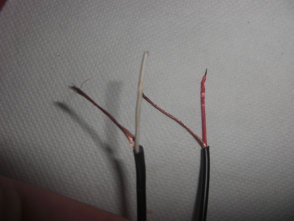

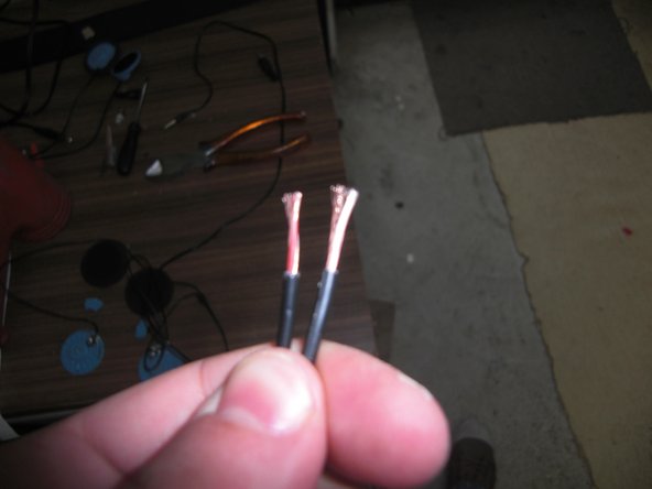

    • Cut the with the side cutting nippers behind the (cinch)plugs
    • remove about 1,5cm of insulation
    • part each 2 wires of each cable
    • As in the picture one cable is not extra insulated this is in my case the ground. The other one carries the signal.
    • Edit: The replacement cable in the pictures had problems... sadly. I think it was because of the long jack-plug. But I found some old apple In-Ear phones with a microphone and used that cable. Now I've got even a microphone on my koss Porta pro!

    • Put some soldering tin on the endings of the deinsulated cables
    • unsold the original cable from the earphones
    • As you can see the right connection has a red dot. This is where you have to sold the cable that carries the signal(In the first picture the insulated one)
    • Arrange the cables before soldering like in the second picture. This formation seems like the best to fix the cable best
    • Sold them and put everything together again. Try this http://www.youtube.com/watch?v=e8ODm-F9-... to find out where to clip them into the rack again :)
