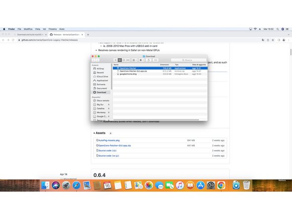

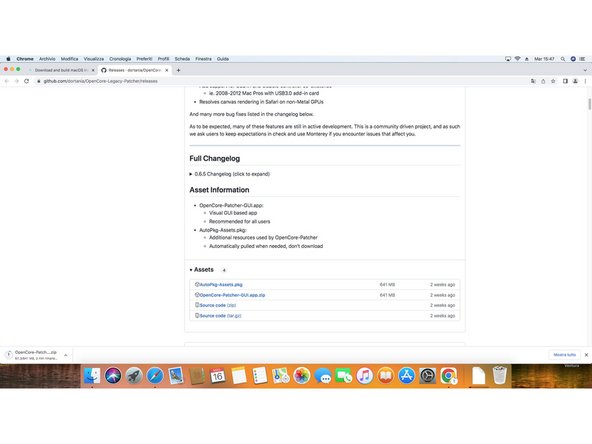

  9. How to Install macOS Sonoma on Unsupported Macs, Download OpenCore Legacy Patcher: crwdns2935265:010crwdnd2935265:01crwdnd2935265:03crwdne2935265:0 How to Install macOS Sonoma on Unsupported Macs, Download OpenCore Legacy Patcher: crwdns2935265:010crwdnd2935265:02crwdnd2935265:03crwdne2935265:0 How to Install macOS Sonoma on Unsupported Macs, Download OpenCore Legacy Patcher: crwdns2935265:010crwdnd2935265:03crwdnd2935265:03crwdne2935265:0
    • Go to this link and check the last release of OpenCore Legacy Patcher. At the time of writing, it was version 0.6.5.
    • Scroll down the page until you find the Assets section of the latest release. Open it and download the file named OpenCore-Patcher-GUI.app.zip.
    • After the download ends, open the zip file to extract the OpenCore-Patcher app and open it.

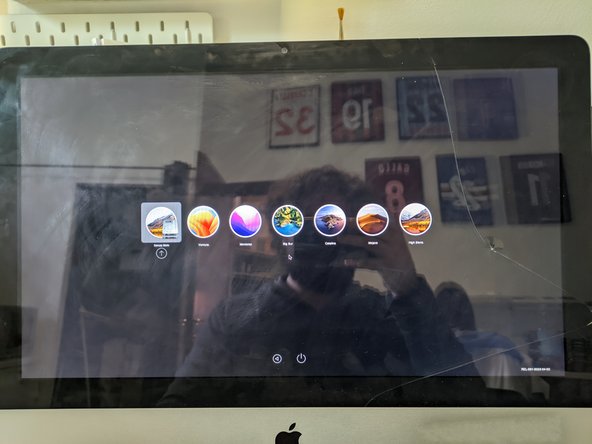

  14. How to Install macOS Sonoma on Unsupported Macs, Reboot to boot disk selection: crwdns2935265:015crwdnd2935265:01crwdnd2935265:02crwdne2935265:0 How to Install macOS Sonoma on Unsupported Macs, Reboot to boot disk selection: crwdns2935265:015crwdnd2935265:02crwdnd2935265:02crwdne2935265:0
    • After OpenCore finish the installation, you will get prompted to reboot.
    • Before rebooting, be sure to have both the EFI USB and the MacOS installer USB inserted in your Mac.
    • While the Mac is rebooting, hold the option key to enter boot disk selection.
    • You can reboot normally, then shut down your Mac and turn it back on while holding down the [option] key.

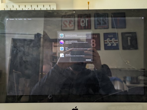

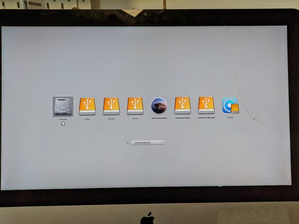

  15. How to Install macOS Sonoma on Unsupported Macs, Install MacOS: crwdns2935265:016crwdnd2935265:01crwdnd2935265:03crwdne2935265:0 How to Install macOS Sonoma on Unsupported Macs, Install MacOS: crwdns2935265:016crwdnd2935265:02crwdnd2935265:03crwdne2935265:0 How to Install macOS Sonoma on Unsupported Macs, Install MacOS: crwdns2935265:016crwdnd2935265:03crwdnd2935265:03crwdne2935265:0
    • After you enter the boot disk selection, select EFI Boot disk (it is the lask USB you created).
    • As you can see, now your Mac does recognize the MacOS Sonoma Installer.
    • Now select the MacOS Sonoma installer and follow the usual MacOS install procedure.
    • In our example we are installing MacOS Monterey, but it works with Sonoma, Ventura and Big Sur too.

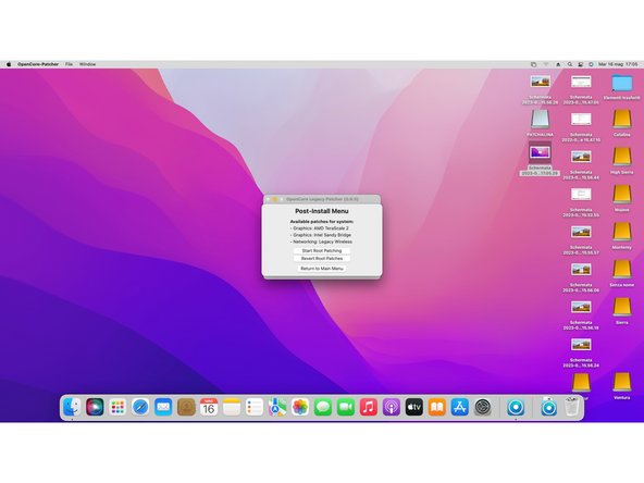

  16. How to Install macOS Sonoma on Unsupported Macs, Post install procedures: crwdns2935265:017crwdnd2935265:01crwdnd2935265:02crwdne2935265:0 How to Install macOS Sonoma on Unsupported Macs, Post install procedures: crwdns2935265:017crwdnd2935265:02crwdnd2935265:02crwdne2935265:0
    • After you finish to install MacOS, open again OpenCore Patcher and select Post Install Root Patch.
    • Then, select Start Root Patching.

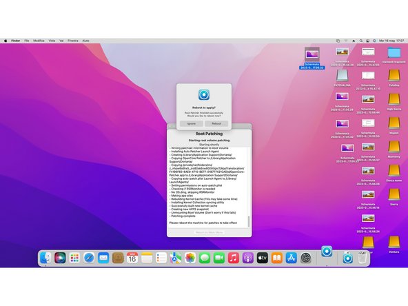

  17. How to Install macOS Sonoma on Unsupported Macs, Post Install Root Patch: crwdns2935265:018crwdnd2935265:01crwdnd2935265:03crwdne2935265:0 How to Install macOS Sonoma on Unsupported Macs, Post Install Root Patch: crwdns2935265:018crwdnd2935265:02crwdnd2935265:03crwdne2935265:0 How to Install macOS Sonoma on Unsupported Macs, Post Install Root Patch: crwdns2935265:018crwdnd2935265:03crwdnd2935265:03crwdne2935265:0
    • OpenCore will ask you to relaunch as root. Select yes.
    • Then OpenCore will start patching your MacOS installation to make it compatible with your Mac.
    • After it finish to patch, it will ask you to reboot apply patches.
    • Be sure you still have the second USB you created plugged in, or you won't be able to start your pc yet.
    • While your Mac reboots, hold down the [option] key to enter again boot disk selection. From there, select again EFI Boot and your Mac will start normally.

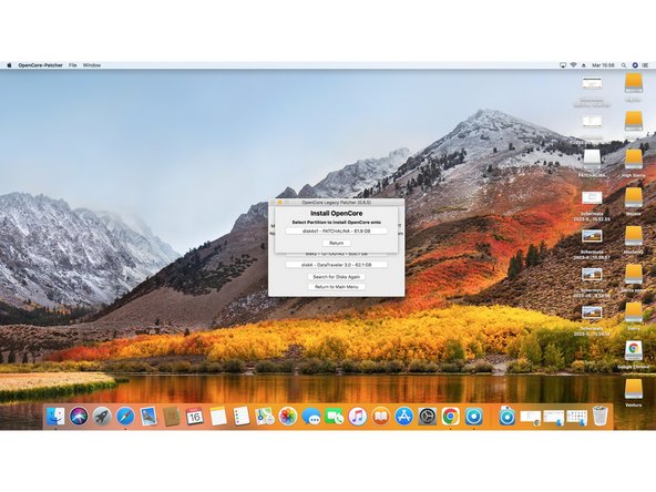

  18. How to Install macOS Sonoma on Unsupported Macs, Build OpenCore: crwdns2935265:019crwdnd2935265:01crwdnd2935265:02crwdne2935265:0 How to Install macOS Sonoma on Unsupported Macs, Build OpenCore: crwdns2935265:019crwdnd2935265:02crwdnd2935265:02crwdne2935265:0
    • Now unplug all the USB drive that are still plugged in.
    • After your Mac boots into MacOS, open one last time OpenCore and select Build and Install OpenCore.

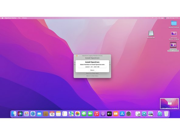

    • After it finish to build OpenCore, select Install to disk.
  19. How to Install macOS Sonoma on Unsupported Macs, Install OpenCore to your EFI partition: crwdns2935265:020crwdnd2935265:01crwdnd2935265:03crwdne2935265:0 How to Install macOS Sonoma on Unsupported Macs, Install OpenCore to your EFI partition: crwdns2935265:020crwdnd2935265:02crwdnd2935265:03crwdne2935265:0 How to Install macOS Sonoma on Unsupported Macs, Install OpenCore to your EFI partition: crwdns2935265:020crwdnd2935265:03crwdnd2935265:03crwdne2935265:0
    • This time select disk0 to install OpenCore to your Mac internal drive, then select the EFI partition.
    • When it finish to install OpenCore, it will ask to reboot your Mac. While it reboots, hold down again the [option] key to enter one last time the boot disk selection.
    • After you enter the disk boot selection, hold down the [option] key and select the EFI disk to make this the default option.
    • Done! You succesfully installed Sonoma on your Mac!
