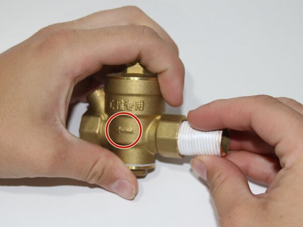

  2. How to Install an RV Toilet Water Pressure Regulator: crwdns2935265:02crwdnd2935265:01crwdnd2935265:02crwdne2935265:0 How to Install an RV Toilet Water Pressure Regulator: crwdns2935265:02crwdnd2935265:02crwdnd2935265:02crwdne2935265:0
    • Screw the nipple onto the regulator, making sure the arrow (marked by the red circle) is pointing away from the nipple.
    • Be sure to screw the nipple in as tight as you can with just your fingers.
