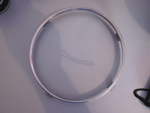

  3. How to Install a LED Headlights on Jeep Wrangler: crwdns2935265:03crwdnd2935265:01crwdnd2935265:02crwdne2935265:0 How to Install a LED Headlights on Jeep Wrangler: crwdns2935265:03crwdnd2935265:02crwdnd2935265:02crwdne2935265:0
    • Remove the metal bracket ring.

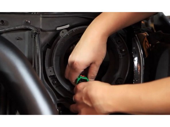

  4. How to Install a LED Headlights on Jeep Wrangler: crwdns2935265:04crwdnd2935265:01crwdnd2935265:03crwdne2935265:0 How to Install a LED Headlights on Jeep Wrangler: crwdns2935265:04crwdnd2935265:02crwdnd2935265:03crwdne2935265:0 How to Install a LED Headlights on Jeep Wrangler: crwdns2935265:04crwdnd2935265:03crwdnd2935265:03crwdne2935265:0
    • Unplug the adapter and remove the stock headlights.

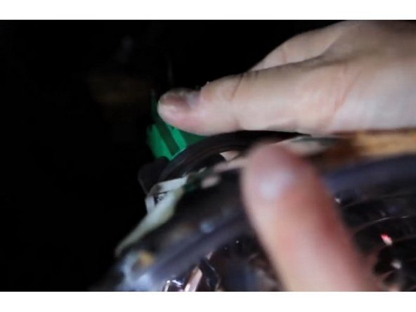

  5. How to Install a LED Headlights on Jeep Wrangler: crwdns2935265:05crwdnd2935265:01crwdnd2935265:01crwdne2935265:0
    • Replace back with the new Jeep Wrangler LED headlights the same way they were removed and connect the adapter.
    • Note: If your Jeep uses an H4 socket instead of H13, you can use the H13 --> H4 conversion adapter that's included in the package.
    • If your head beam does not work at all during the initial installation, please check both the adapter on the LED headlights and the LED driver module box.
    • Make sure no pins are pushed out.
    • If the problem persists, you may need to re-pin the adapter.
    • If the high beam takes a couple tries to turn on, it means that there's not enough power being supplied.
    • The battery may need to be replaced or you may have to add a relay harness to directly draw the power from the battery.
    • If you experience the issue where your high beam is periodically flickering, you will need an anti-flicker decoder to solve the problem once and for all.
    • Sometimes, the issue will be localized on one side only.
    • If that's the case, you will need to switch the LED driver module box from the driver side to the passenger side and vice versa to see if the module box is the issue.
