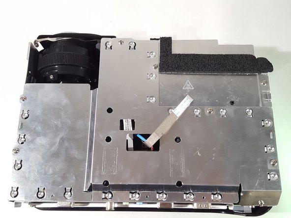

    • Start by removing the two screws on the bottom of the device as shown.
  2. How to Get Rid of Fan Clicking Noises on a Toshiba TDP-XP2: crwdns2935265:02crwdnd2935265:01crwdnd2935265:02crwdne2935265:0 How to Get Rid of Fan Clicking Noises on a Toshiba TDP-XP2: crwdns2935265:02crwdnd2935265:02crwdnd2935265:02crwdne2935265:0
    • Remove the top plastic cover from the device. The back is snapped on so it would help to have leverage from a prying tool.
    • Remove the ribbon cable attached to the plastic piece just removed. Remember its orientation for re-assembling later.
  3. How to Get Rid of Fan Clicking Noises on a Toshiba TDP-XP2: crwdns2935265:03crwdnd2935265:01crwdnd2935265:02crwdne2935265:0 How to Get Rid of Fan Clicking Noises on a Toshiba TDP-XP2: crwdns2935265:03crwdnd2935265:02crwdnd2935265:02crwdne2935265:0
    • Unscrew the screws from the metal shielding to remove it.
  4. How to Get Rid of Fan Clicking Noises on a Toshiba TDP-XP2: crwdns2935265:04crwdnd2935265:01crwdnd2935265:01crwdne2935265:0
    • Move any wires out of the way of the fan so they won't grind up on it during operation.
    • If the cables do not stay out of the way, tape them down away from the fan.
