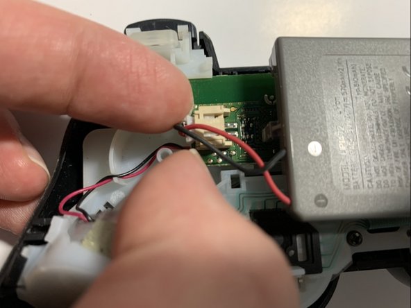

    • Disconnect the battery from the controller by pressing the two sides of the connector and pulling it out.
    • Do not pull on the red and black wires to avoid damaging the connection.

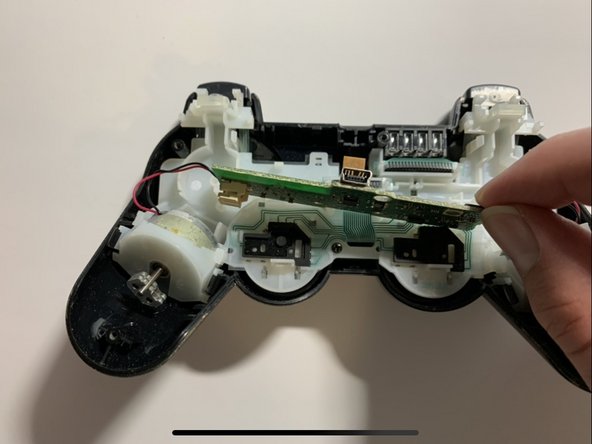

  4. How to Fix/Prevent Joystick Drift on a DualShock 3: crwdns2935265:04crwdnd2935265:01crwdnd2935265:02crwdne2935265:0 How to Fix/Prevent Joystick Drift on a DualShock 3: crwdns2935265:04crwdnd2935265:02crwdnd2935265:02crwdne2935265:0

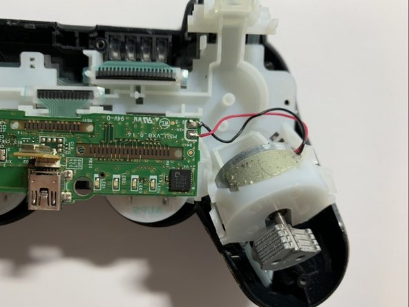

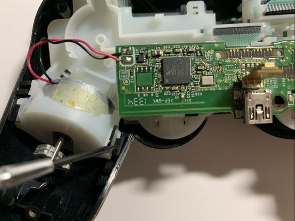

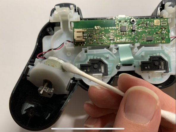

    • Use a toothpick to remove any sticky dirt like substances from the rumble motors.
    • Use the cotton swab to remove any dust particles or hairs from the rumble motors.
  5. How to Fix/Prevent Joystick Drift on a DualShock 3: crwdns2935265:05crwdnd2935265:01crwdnd2935265:02crwdne2935265:0 How to Fix/Prevent Joystick Drift on a DualShock 3: crwdns2935265:05crwdnd2935265:02crwdnd2935265:02crwdne2935265:0
    • Remove the motherboard by pushing the two white hooks on both the left and right side of the motherboard backwards.

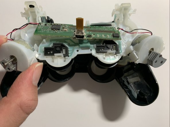

    • To remove the white body piece, start by using your fingers to unhook the small black hooks securing the left and right rumble motors.
  8. How to Fix/Prevent Joystick Drift on a DualShock 3: crwdns2935265:08crwdnd2935265:01crwdnd2935265:02crwdne2935265:0 How to Fix/Prevent Joystick Drift on a DualShock 3: crwdns2935265:08crwdnd2935265:02crwdnd2935265:02crwdne2935265:0
    • Remove the white body piece from the controller by pushing the unhooked left and right rumble motors in an upward direction.

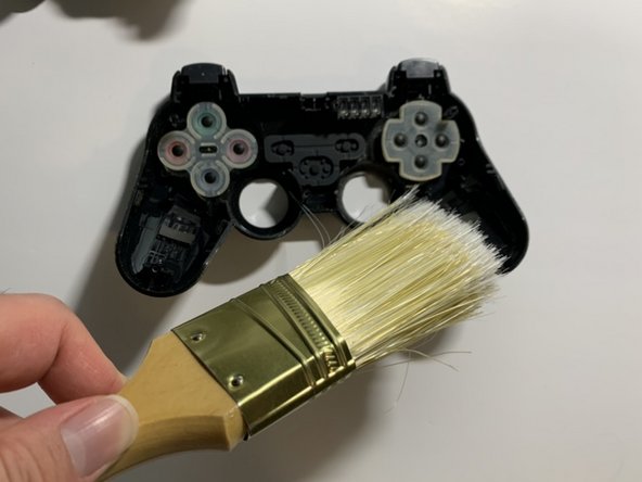

    • Use the brush to remove dust/dirt particles from the inside of the front shell.
    • Use a cotton swab to remove any dust/dirt particles in smaller crevices.
