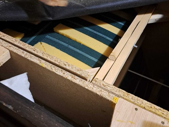

    • First get one or two partners depending on how big the sofa is to flip the sofa upside down with you.
  2. How to Fix an Unleveled Sofa Seat: crwdns2935265:02crwdnd2935265:01crwdnd2935265:03crwdne2935265:0 How to Fix an Unleveled Sofa Seat: crwdns2935265:02crwdnd2935265:02crwdnd2935265:03crwdne2935265:0 How to Fix an Unleveled Sofa Seat: crwdns2935265:02crwdnd2935265:03crwdnd2935265:03crwdne2935265:0

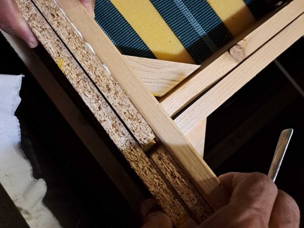

    • To find the exact problem of making the sofa seat unleveled, use a utility knife to cut a line across the corners of the big sheet covering the wood in the sofa.
    • Remove the big sheet covering the wood in the sofa seats to expose the problem, as the wood is what holds the sofa together.
  3. How to Fix an Unleveled Sofa Seat: crwdns2935265:03crwdnd2935265:01crwdnd2935265:01crwdne2935265:0
    • Find the unleveled wood in the sofa seat which was the cause of the unleveled sofa seat.

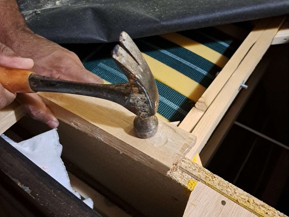

  4. How to Fix an Unleveled Sofa Seat: crwdns2935265:04crwdnd2935265:01crwdnd2935265:03crwdne2935265:0 How to Fix an Unleveled Sofa Seat: crwdns2935265:04crwdnd2935265:02crwdnd2935265:03crwdne2935265:0 How to Fix an Unleveled Sofa Seat: crwdns2935265:04crwdnd2935265:03crwdnd2935265:03crwdne2935265:0
    • Using a hammer, put a piece of wood on top of the unleveled wood, allowing you to have a larger surface to hammer on as you try to align the unlevelled wood back into its position.

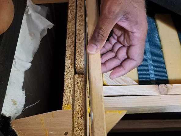

  5. How to Fix an Unleveled Sofa Seat: crwdns2935265:05crwdnd2935265:01crwdnd2935265:01crwdne2935265:0
    • Take measurements for a piece of wood that spans the break, reaching both the recently unleveled wood and the already sturdy wood in the sofa.
  6. How to Fix an Unleveled Sofa Seat: crwdns2935265:06crwdnd2935265:01crwdnd2935265:03crwdne2935265:0 How to Fix an Unleveled Sofa Seat: crwdns2935265:06crwdnd2935265:02crwdnd2935265:03crwdne2935265:0 How to Fix an Unleveled Sofa Seat: crwdns2935265:06crwdnd2935265:03crwdnd2935265:03crwdne2935265:0
    • Glue up one side of the piece of wood that was just cut out.
    • Place that wood firmly on a surface that reaches the wood that was recently unleveled and also in the same line a piece of wood that was already sturdy in the sofa.

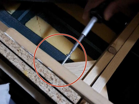

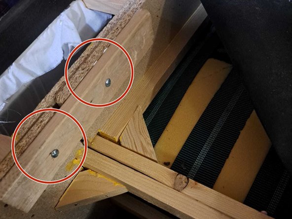

    • Take one screw and screw it into where where it goes through the new piece of wood first, then into the recently levelled piece of wood.
    • Take another screw then screw it into where it goes through the new piece of wood first, then into the other piece of wood that is glued other than than the recently unleveled piece of wood.
