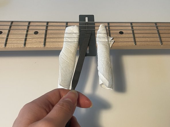

    • Place the fret guard underneath the strings and over the uneven fret.
  4. How to Fix an Uneven Guitar Fret: crwdns2935265:04crwdnd2935265:01crwdnd2935265:03crwdne2935265:0 How to Fix an Uneven Guitar Fret: crwdns2935265:04crwdnd2935265:02crwdnd2935265:03crwdne2935265:0 How to Fix an Uneven Guitar Fret: crwdns2935265:04crwdnd2935265:03crwdnd2935265:03crwdne2935265:0
    • Take one paper towel sheet and fold in half the long way.
    • Roll the paper towel tightly about halfway down the sheet.
    • Cut the paper towel as pictured.
    • Repeat once more, you should have two small paper towel rolls.
  5. How to Fix an Uneven Guitar Fret: crwdns2935265:05crwdnd2935265:01crwdnd2935265:01crwdne2935265:0
    • Place the two rolls under the strings around the fret guard.
  6. How to Fix an Uneven Guitar Fret: crwdns2935265:06crwdnd2935265:01crwdnd2935265:02crwdne2935265:0 How to Fix an Uneven Guitar Fret: crwdns2935265:06crwdnd2935265:02crwdnd2935265:02crwdne2935265:0
    • File the top of the fret in an up down motion
    • Start slow, file back and forth only a couple times then see step 7
