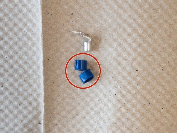

  6. How to Fix an Overextending Holga 120N Camera Shutter: crwdns2935265:06crwdnd2935265:01crwdnd2935265:02crwdne2935265:0 How to Fix an Overextending Holga 120N Camera Shutter: crwdns2935265:06crwdnd2935265:02crwdnd2935265:02crwdne2935265:0
    • Slice the blue plastic off of the spade terminal with the boxcutter/Exacto-knife.
    • The plastic bottom is sealed on very tightly. Use caution when cutting it away!
    • Remove the plastic from the spade terminal.
