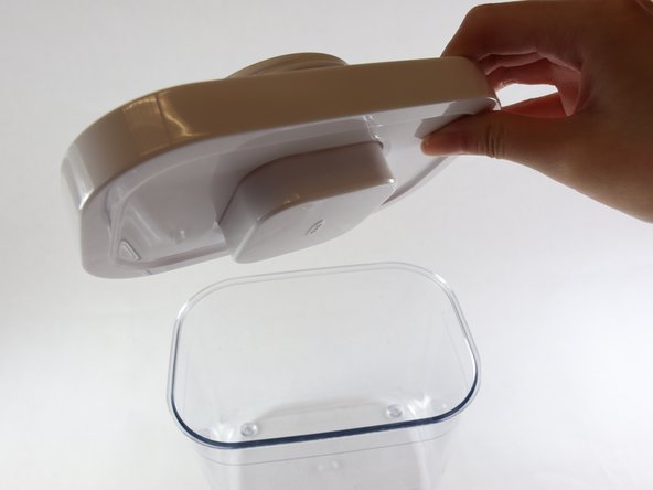

    • Hold the lid with the button facing down.
    • Twist the flat part in the direction of the arrows or counter clockwise.
  2. How to Fix an OXO Container's Jammed Button: crwdns2935265:02crwdnd2935265:01crwdnd2935265:03crwdne2935265:0 How to Fix an OXO Container's Jammed Button: crwdns2935265:02crwdnd2935265:02crwdnd2935265:03crwdne2935265:0 How to Fix an OXO Container's Jammed Button: crwdns2935265:02crwdnd2935265:03crwdnd2935265:03crwdne2935265:0
    • Firmly pinch both the half-moon shaped openings.
    • Pull up the removed outer piece and set it aside.
  3. How to Fix an OXO Container's Jammed Button: crwdns2935265:03crwdnd2935265:01crwdnd2935265:01crwdne2935265:0
    • Place the lid perpendicular and onto the top of the container's opening.
    • The button should pop out. Placing the lid on a flat surface will prevent them from coming out.
    • Locate the two holes.

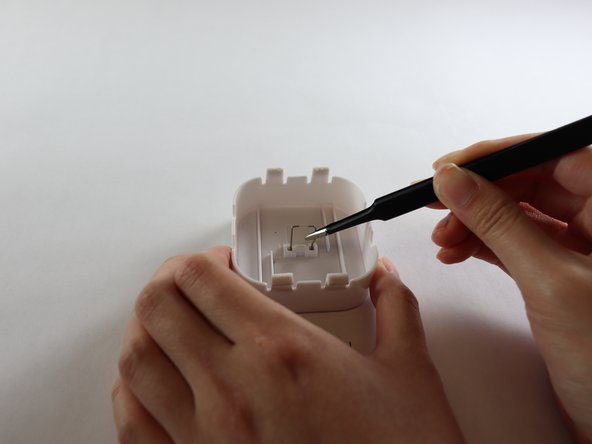

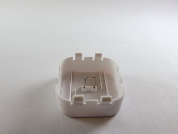

  6. How to Fix an OXO Container's Jammed Button: crwdns2935265:06crwdnd2935265:01crwdnd2935265:03crwdne2935265:0 How to Fix an OXO Container's Jammed Button: crwdns2935265:06crwdnd2935265:02crwdnd2935265:03crwdne2935265:0 How to Fix an OXO Container's Jammed Button: crwdns2935265:06crwdnd2935265:03crwdnd2935265:03crwdne2935265:0
    • Flip the button so the inside wire faces upwards.
    • Use pliers to bend the wire similar to its original shape.
    • Use the unbent wire as a reference to reshape the bent wire.
To reassemble your device, squeeze the button back onto the lid and follow these instructions in reverse order.
