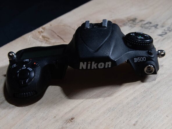

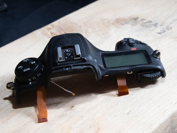

  17. How to Fix a not working metering mode, Lift Top assembly free: crwdns2935265:019crwdnd2935265:01crwdnd2935265:03crwdne2935265:0 How to Fix a not working metering mode, Lift Top assembly free: crwdns2935265:019crwdnd2935265:02crwdnd2935265:03crwdne2935265:0 How to Fix a not working metering mode, Lift Top assembly free: crwdns2935265:019crwdnd2935265:03crwdnd2935265:03crwdne2935265:0
    • Carefully lift the top assembly free.
    • Note, there is a thermal pad on the left hand side, almost right under where the strap lug is. Red Box. Careful to not damage it.

    • Once the top assembly is disconnected from the rest of the camera, the area for the service is highlighted in the green.
    • Connect an anti-static strap to the magnesium shell, making sure it touches some unpainted part, to make sure you don't damage any components.
    • (This picture came from an ebay part listing)
