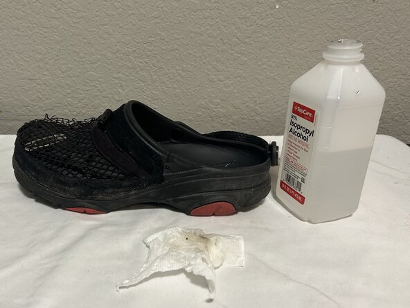

    • Use rubbing alcohol and a paper towel to clean the surface of the shoe where the repair will be done.
  2. How to Fix a Torn Strap Attachment on Crocs: crwdns2935265:02crwdnd2935265:01crwdnd2935265:01crwdne2935265:0

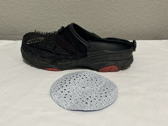

    • Prep the surface of the shoe with a few passes of sandpaper.
    • This will make the surface porous and allow the glue to make a stronger hold.
    • Give the repair location a second cleaning with rubbing alcohol to remove any debris from sanding.

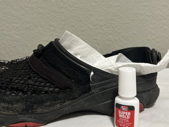

  3. How to Fix a Torn Strap Attachment on Crocs: crwdns2935265:03crwdnd2935265:01crwdnd2935265:01crwdne2935265:0
    • Protect the rest of the shoe from glue spill with a paper towel or parchment paper.
    • Because the glue bonds to skin quickly, put on gloves for the next steps.

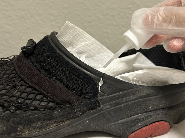

  4. How to Fix a Torn Strap Attachment on Crocs: crwdns2935265:04crwdnd2935265:01crwdnd2935265:01crwdne2935265:0
    • Apply glue in between any lower cracks in the shoe plastic. Leave the top tear open for the strap button to go through again in the next step.
    • Allow the glue to set up for at least an hour.

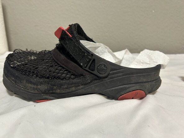

  5. How to Fix a Torn Strap Attachment on Crocs: crwdns2935265:05crwdnd2935265:01crwdnd2935265:01crwdne2935265:0
    • With the bottom of the tear secured, carefully insert the strap button through the top of the tear.
    • The top of the tear will be glued only once the strap is secured.

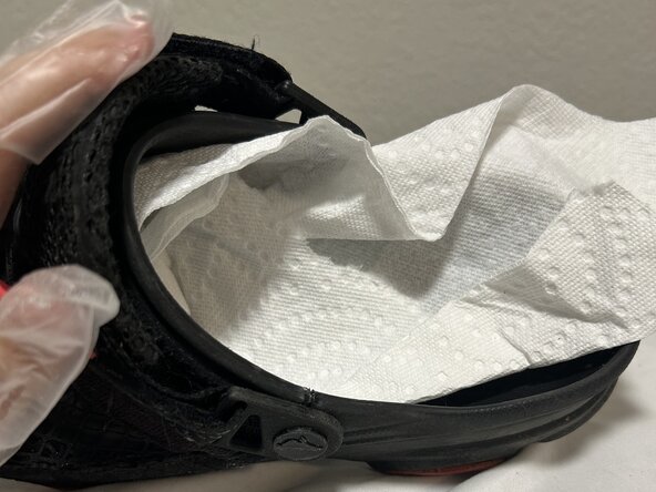

  6. How to Fix a Torn Strap Attachment on Crocs: crwdns2935265:06crwdnd2935265:01crwdnd2935265:01crwdne2935265:0
    • With gloves on, apply glue in the upper tear. Make sure not to get glue on the strap- it still needs to be able to rotate.
    • Allow the glue to dry to the specifications of package instructions before wearing.
