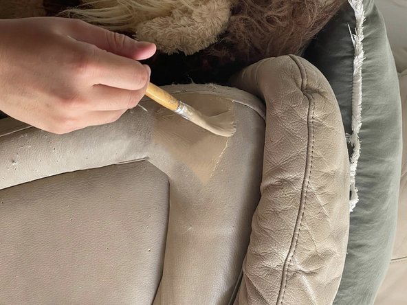

    • Once the patch is stable and dry, use a spatula to apply the leather repair filler in the crevice until you have an even surface.
  6. How to Fix a Tear on a Leather Couch: crwdns2935265:06crwdnd2935265:01crwdnd2935265:02crwdne2935265:0 How to Fix a Tear on a Leather Couch: crwdns2935265:06crwdnd2935265:02crwdnd2935265:02crwdne2935265:0
    • Use sandpaper to smoothen and even out the surface once it's dry.
    • Use the sandpaper to remove any excess filler or wipe it off with alcohol on a damp washcloth.
  7. How to Fix a Tear on a Leather Couch: crwdns2935265:07crwdnd2935265:01crwdnd2935265:02crwdne2935265:0 How to Fix a Tear on a Leather Couch: crwdns2935265:07crwdnd2935265:02crwdnd2935265:02crwdne2935265:0
    • Brush over the heavy filler using a leather paint that matches the color of your sofa.
