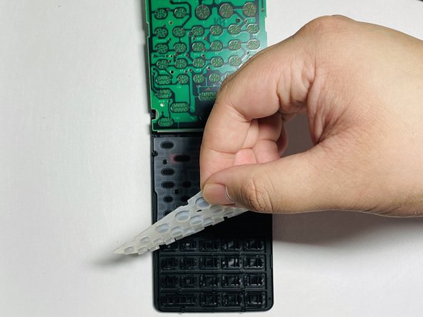

  6. How to Fix a Stuck Button in Sharp Calculator: crwdns2935265:06crwdnd2935265:01crwdnd2935265:02crwdne2935265:0 How to Fix a Stuck Button in Sharp Calculator: crwdns2935265:06crwdnd2935265:02crwdnd2935265:02crwdne2935265:0
    • Lift the motherboard by holding both sides and placing it on the top panel.
    • Lift the grey padding upwards by holding any corner and place it on top of the motherboard.
    • Press the grey padding and put pressure downward to avoid sticking from physical buttons.

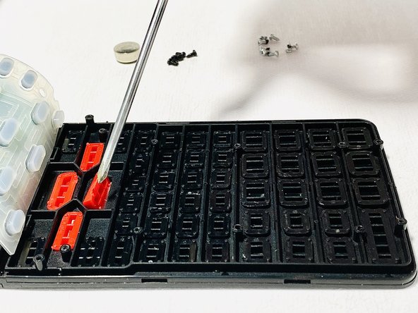

  7. How to Fix a Stuck Button in Sharp Calculator: crwdns2935265:07crwdnd2935265:01crwdnd2935265:02crwdne2935265:0 How to Fix a Stuck Button in Sharp Calculator: crwdns2935265:07crwdnd2935265:02crwdnd2935265:02crwdne2935265:0
    • Use a spudger to flip, remove, and adjust the position of buttons.
    • Ensure the placement of buttons is correct. Use STEP 1 Image as a reference to the location of buttons.
