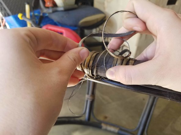

    • Remove and save rattan from broken sections.

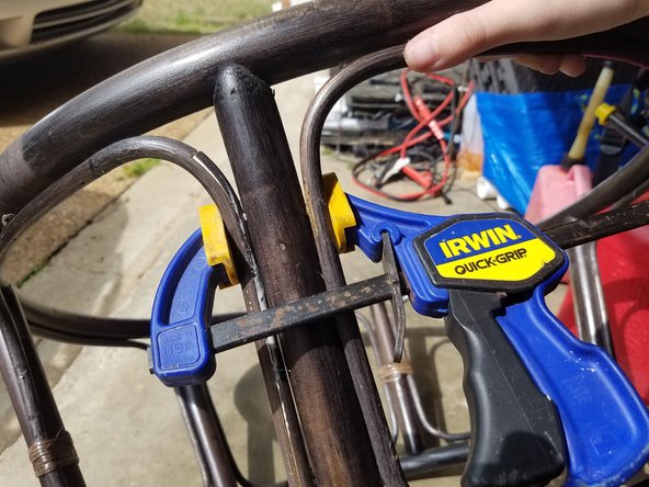

  3. How to Fix a Papasan Chair Base: crwdns2935265:03crwdnd2935265:01crwdnd2935265:02crwdne2935265:0 How to Fix a Papasan Chair Base: crwdns2935265:03crwdnd2935265:02crwdnd2935265:02crwdne2935265:0
    • Glue the split wood pieces together, clamp, and let them dry.

  7. How to Fix a Papasan Chair Base: crwdns2935265:07crwdnd2935265:01crwdnd2935265:02crwdne2935265:0 How to Fix a Papasan Chair Base: crwdns2935265:07crwdnd2935265:02crwdnd2935265:02crwdne2935265:0
    • Nail down one side of the rattan and re-wrap it. Finish by nailing down the other end of the rattan to secure it.
